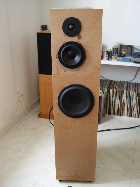

I´m finising my tree way speakers and thinking seriously to go active.
My question is if it´s possible to use the DCX (or whatever else crossover, analogic or digital) without having measurement instrumental (like micro, ....). Just "tunning" it by ear.
RANE manual insist always on using a micro to get the right setting.

Hi Spearmint,
I´m thinking to buy a custom made active crossover for my speakers, from a guy that make electronic equipment like power amplifiers, phono RIAA, and so...
You can visit his page about active filters:
http://www.pcpaudio.com/filtros/filtros.html
(sorry, only in spanish)
He tolds me Behringer use VERY BAD analogic parts on DCX. Thats would explain the very low price for that digital crossover. He speaks much better about the components on RANE and BSS crossovers.
I can´t tell you anymore because I didn´t hear any crossover yet, I´m just giving my first steps to active, but there must be sound differences between good and bad capacitors, don´t you think so?
