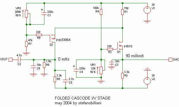

FOLDED CASCODE
Hallo,
I designed this I/V conversion based on PASSLABS circuits .
There is a thing that I do not find objectionable and I ask for help:
the fact is that the output drain dc point (at Q2)moves around into +/- 15 or so millivolts. Is it normal? Or is it a suspect of oscillation ?
All other points are dc stable.

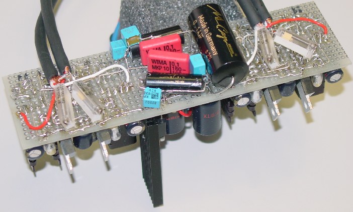

Hi Arne,
no, I did not design&produce PCBs for this, I built up this circuit on a experiment board and did hard core wiring... A perfect layout, drawn on paper before, is mandatory, as well as tons of patience.
The TDA1547 was given in my commercial DAC, I just implemented this additional board.
Regards
Klaus
