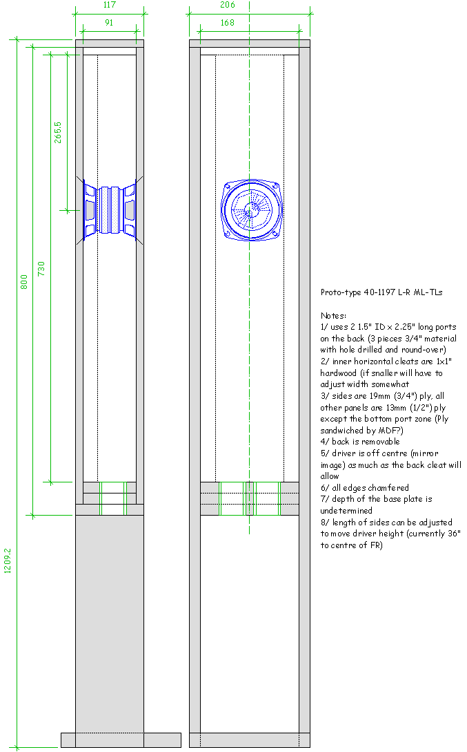

Thanks for the info, but I still have a few more questions...
Sticking with the pipes (wooden and red), do you have drawing with measurements for them? Do you use a filter or anything on the 40-1197 drivers? How are they connected, series or parallell and are they in phase?
The prototype drawing you posted has several similarities for the AllegraAudio BV-1 (minus the taper). What is the benefit of placing the drivers back to back? Also, do you hook them up in phase? Is the horizontal location of the driver critical? I would prefer to have it a sitting ear level.

gmilitano said:Sticking with the pipes (wooden and red), do you have drawing with measurements for them? Do you use a filter or anything on the 40-1197 drivers? How are they connected, series or parallell and are they in phase?
Is more information regarding the 40-1197 not available (i.e. freq. responce curves, Re .....)
BD-Pipes plans
http://pmillett.addr.com/tqwp.htm
Drivers connected in parallel or series & in phase (i am starting to get some feedback that, particularily with tube amps, 16 ohms makes a biggere difference than i would have guessed -- i have yet to experiment).
No filters, just "mechanical" tweaks. Ductseal, puzzlecoat, woolfelt, dustcapectomy, phase plugs... the ductseal is a required tweak.
The ptototype is probably similar to Tim's pipes because, he says, he has been inpired by my preaching 🙂
Back-to-back makes them CRT friendly and gives optimal push-push coupling (inproved downward dynamic range, reduced transmission of energy to the box). In phase. Driver distance from the end of the pipes is critical. Ajust height by changing the length of the "legs (everything below the port is purly to get the driver up to the right height).

I like this design too. Do I need to experiment with insultation? I believe Tim insulated the upper portion of his. If I was to add a tweeter, does it need to be isolated from the inside of the box?

Furthermore, the 40-1030 does not seem to be available anymore would the 10CM (4") WOOFER 40-1022 be an appropriate replacement?
I've only used the same speaker as in the front, i think the 1022 is a bit down efficieny-wise -- i'd just use 2 1197s per box.
No... the designated amount of stuffing just fit into the box.
Ok, with regards to the numbers, the link Tim gave showed an efficiency of about 90.5 db. By using two drivers, what would be the net efficency? I imagine I would need to know this to pick an appropriate tweeter.
Tim's uses 2 drivers 90.5-91 dB is about right.
I think it is clear that the low end of the 1197 is about 80Hz. How much is this value lowered by the enclosure or by the back to back setup. What I am asking is what would be the estimated frequency responce and would a subwoofer be required.
Listen to them, if you want subteranean bass you will need woofers (modern day drivers designed for sub use, usually don't have enuff top end to blend well).
dave
Thanks for the info Dave.
With regards to the stuffing on the proto-1197-ml-tl, there are no details regarding stuffing.
If the individual drivers are about 90.5 dB, does using two drivers increase the efficiency?
You also mentioned that the height of the enclosure is critical. How is this height determined? Is it based on experimentation, or can software be used to model the enclosure. I have been playing with speaker workshop .. is this approprite or do I need something different?
