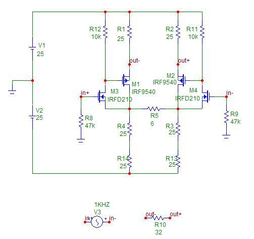

Hi All

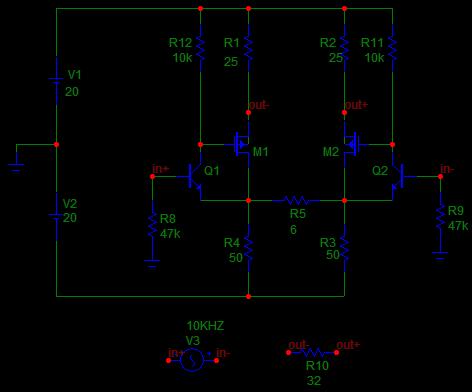

Let me know what you think of this headphone amp design.
It is a combination of the Son of Zen amp and a bipolar-mosfet interpretation of the CFP.
The design simulated well so i am building it.
Instead of the BC549C's i am using a LM394 and i hand matched the resistors to 5dp's
I am really interested in hearing your feedback.
Thankyou
Tim

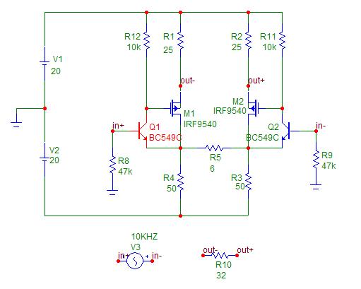

I just noticed I didn't include the transistor types in the circuit, so some of my previous post didn't make much sense.
Q1 and Q2 were simulated as BC549C's but i used a LM349 in the actual circuit.
M1 and M2, just about any P-Channel mosfet seemed to work. i simulated and used IRF9540's, cause i had them.
Boy, it's hard to read your schematic! Could you put it on a white background instead?
Or maybe it's me....

Why not just build the ZEN 6 with IRF610`s just scaling all the
resistors by a factor of 3 ? By the way at these power levels
some good mills resistors and or a battery power supply wouldn`t break the bank.

Would you scale ALL the resistors? Or just the ones setting the bias? What would be the resulting bias? Thanks
Why not try your own circuit? It looks very simple. Would you modify your headphone cable to give you 4 wires instead of 3 (eliminating the common ground)?
You can always build a Zen version later and compare the two.

I am already building my circuit!
I have finished the amplifer but i have yet to finish building the PSU, attenuator and the case.
i have had a brief listen to it, connected to a lab supply and it sounds really good, but i was running it from my rotel preamp and believe it can sounds even better with a passive stepped attenuator connected directly to my cd player.

This circuit is an enhanced version of the son of zen, it has the advantages of improved linearity and wider bandwidth with the addition of just a few extra camponents. In fact either of the actual son of zens and the balanced zen line stage could be modifed to give improved performance with this mod (i might even do the sims on this and publish the results).
Though modifiing it to the supersymetric design is a really good idea and is something i should try out in the simulations 🙂
Measurements:
The simulated measurements for the current design are such:
%THD @ 10kHz = 0.02%
%THD @ 1kHz = 0.015%
The -3dB bandwidth is 7Mhz (and probably should be reduced!)
The distortion figures are measured just before the onset of clipping, into a 32R load, and reduce from there.
Tim

supersymmetric headphone amp
Well i have converted the simulation of my enhanced son of zen headphone amp to the supersysmmetric layout like zen v6 and I cannot improve its performance over my original design. But her is what i have come up with:

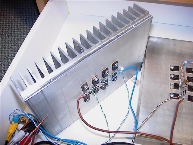

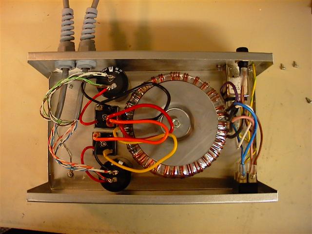

As promised I was going to post some constructional pics of my amp.
The first one is the amps on their heatsink.
I guess people, who havn't simulated it already, are wondering why such large heatsinks for a headphone amp! The reason is because I believe there is no such think as too much headroom...This design runs ~400mA in each half of the design for a total of ~800mA current per channel, which means this amp is dissapating ~32 Watts of heat per channel!

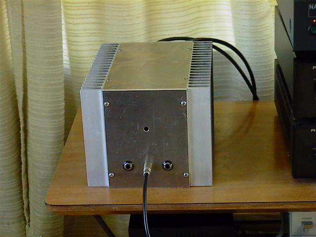

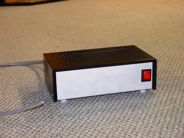

I am thinking of getting a bigger box because the one i ordered is a little flimsy for the size of the transformer. Another think i am planning to do is add inductors to the filtering but i will see how this sounds first.
Here is the PSU from the front:
Tim

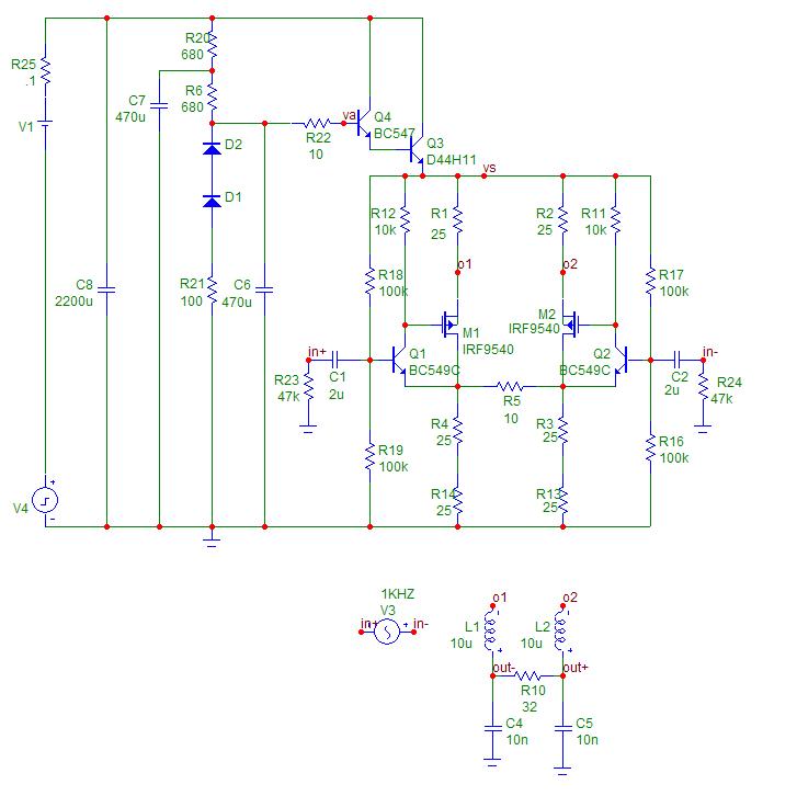

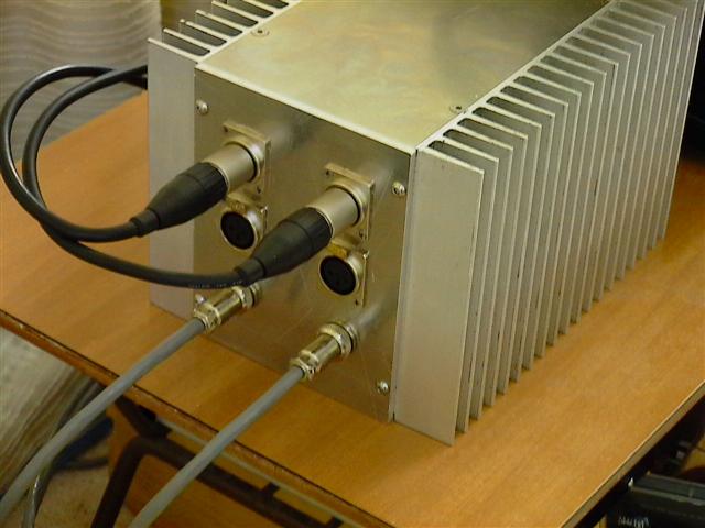

Listening tests
I have finally put it together and have spent the last two weeks listening to it and most of my music collection.
I am not good at describing what i hear but I think it sounds really good! With a very transparent detailed sound.
I have modified the circuit a little, it is running on a single supply rail and have added a simple high speed low noise regulator to reduce any ripple to way into the noise floor and now it is incredably quiet.
One downside with this design is the channels are too isolated and the sound stage is between my ears, so i am planning to add a natural crossfeed circuit (but balanced) as in Jan Meiers circuit:
http://headwize.com/projects/showproj.php?file=meier_prj.htm
Another idea i have had it to use it as a balanced preamp, i just have to sort out a suitable balanced volume control and to use it to drive my new balanced supersymmetry amp.
I have attached the modifed circuit and I will have to post some pics of it completed design, it looks like a headphone amp on steriodsjavascript:smilie('😀')
Enjoy
Tim
