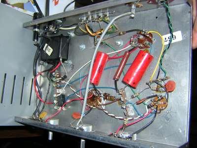

Hi, I noticed this thread about converting a Bogen PA to a guitar amp, and I thought I'd ask a similar question: Can a PA amp be "converted" to be used as a "hi fi" amp? The reason I ask is because I recently aquired a pair of mono 10W Bogen Challenger PA amps. They have an RCA input labeled phono, and a screw-on type input labeled Mic. There are three pots:Volume for MIC, volume for phono, and Treble. There is a 3 pronged speaker socket on the back, as well as a standard screw terminal speaker output for 4, 6, and 8 ohm as well as one labeled 24V (?). Each amp uses two tubes, a 12AX7, and a 7868 (Sylvania). I hooked up a portable MD player and a Discman to the single RCA connecter on each amp labeled phono, and connected a pair of Paradigm Titan speakers. The amps I think sound pretty decent, but not especially sweet or special. The sound is pretty clear, maybe with a bit of low hummy buzz due to the fact that they may need new caps. If turned up much beyond the halfway mark on the volume, they distort a little, but only on loud, dense, or bassy music. The distortion is more like and overdriven sound on a guitar amp.
So I have a few questions for the people that know more about this type of thing than me:
What exactly is the difference between a PA amp and a "hi fi" amp?
I don't have a schematic for these, does anyone know where I could get one? Although they are very simple, I could probably draw my own schematic by tracing the wires.
Since the input is labeled phono, I assume this means it's for a turntable. But I plugged a Discman at full volume into it and it didn't seem to have a severely distorted effect like I would expect when you plug a line level input into a phono pre. Like I said, only slightly overdriven when at near max volume. Could amps like these have some sort of built in phono preamp? I have not tried plugging a turntable directly into it though.
I'd like to rebuild these and modify them if possible to be optimized for music listening as a mono block type set up with a preamp of some sort. Could I or should I disconnect the Mic input to improve sound or eliminate any unneeded parts? Maybe there are some resistor values to be changed or removed (or added) somewhere? Maybe with capacitors too? Of course this is assuming there is some difference in a PA amp and a hi fi amp.
Since I got these for very cheap, I don't expect to make anything super amazing out of them, but I figure there might be some things I could do to improve their sound a bit and use them as a small stereo for a small bedroom to be used at medium and low listening volumes. Even if I replaced a bunch of parts this would still cost me less than $100 for a little mono block tube stereo/bookshelf type system.
Last question: Am I crazy for thinking I could make a good sounding little mono block stereo out some junky little PA amps? :)
Often PA amps are designed fairly conservatively, so they can be left on for 20 years and not die. No kidding. But many of the best amps (example: LEAK TL12 point one) were used for PA but were also very good for hifi.
In my opinion, you would be best off stripping back all of the old components and building a "modern" design. You only need to change passive components like caps and resistors, build a much simpler design with perhaps 10 components per channel. If the amps already work, you're halfway there.
The 7868 is a bit of an oddball, but it is easy to drive. You could possibly chuck in a EL84 instead, but it has a different pinout.
If your 7868s are a bit weak, there will not be too much power. The amp should go fairly loud before distorting (depending on speakers of course.) If they seem to have a fair bit of grunt then the 7868s are probably ok.
I would adapt a SE 12AX7- EL84 schematic. There are plenty on the net. You could probably get away with 1/2 12AX7 (its a dual triode in one glass) into a 7868. Very conventional but will work just fine.
If you have a digi cam, post photos of the top and the wiring, you can attache them to your posts.
IMHO, you have a good little project there, well worth doing.

All the passive components are new (Antique Electronic Supply). Orange drop and Atom caps, metal film resistors, including a new 4-gang multi capacitor aluminum can thingy (C33A, B, C, D). Do any of these caps have to be "formed"?
Some caps (e.g. orange drops) aren't marked with polarity. Does that mean it doesn't matter and I can install them in either direction?
The original values for C33A-B-C-D are 40-20-210-10 mf respectively but the closest equal or larger values I could find in one aluminum can are 40-20-20-20 mf. What difference wil this make?
Any other comments, observations, corrections, etc.?
