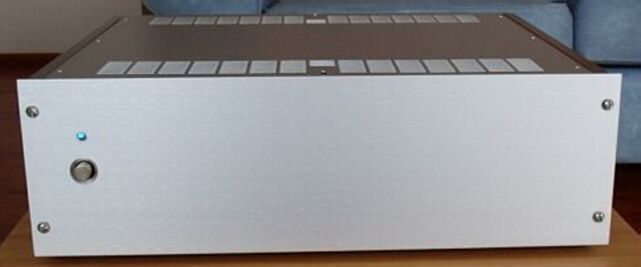

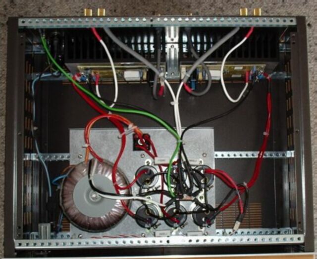

Just finished a P101......
Started out as an amp for a sub but after testing was far too good so ordered another PCB to make a stereo power amp, the low power version....... about 75W - 8ohm.
I won't go into a heap of adjectives but this is one fine amplifier that outdoes any Rotel, Marantz or NAD etc and in my 30+ years in this game it is one of the finest amps I've ever heard and that's going through a Rotel preamp. A P88 preamp would better? Don't know...... maybe someone could tell me. This amp really takes control of the speaker.
All components were just run of the mill from Jaycar, WES and Altronics (Oz suppliers) and from the sound I'm not going to replace them with any boutique components. I think Rod has done this design so you don't have to use the super special components but I'm sure they would enhance the design. IMO, a great design is more important. The power supply is a simple well thought out design that's very effective.... the more I look at it, the more clever I think it is.
As far as too much bass...... phooey. I'm using floorstanders with Peerless 850122 drivers with an F3 around 40Hz and not too much at all. All a matter of taste I suppose.
Rod was very helpful with any questions and the only problem I had was actually seeing some of the components that were grouped tightly when soldering....... old age.... [sigh].
Look out there's a new kid in town......... the P101...... take a bow Rod.
Here's some pics.
