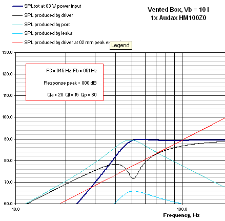

Hmm, I've just jumped on the wagon too. With a single driver in a 10l ported enclosure Unibox gives me an f3 of 45Hz! Max input of 3W and driver unloads below f3. SPL is 87.5db at f3 and ~90db from 55Hz upward. Used 'walls covered' stuffing parameter.OK I cannot get 50hz f3 in a 9l ported box whatever tuning frequnecy I choose. The best I can get is 55. I am using 100% fill...

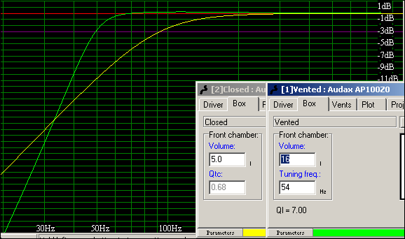

Hmm, as they're so cheap, and need such small boxes, might it be a nice idea to load each driver slightly differenty, to get smoother bass?
For example, one sealed, two ported - each at a different tuning frequency. This could surely be used to make the speaker's bass a bit more 'exciting'.
Ok, maybe 1 sealed in a diddy 5L section, and two ported sharing 16L, tuned to 54hz. And this could all sit in a very small floorstanding box of 14cm width, 25cm depth, and 70cm height (internal). Maybe a little taller and a tweeter would go in the right place.
