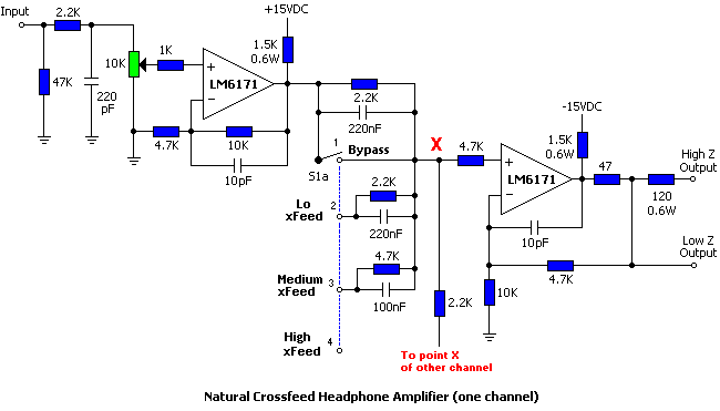

Hi!
Peranders; I have to cool down OPA2604; I have an information now that they could be oscilating on high freq. - maybe that is the reason for my heating. I am building some headphone amps using Jan Meier schematic with some natural crossfeed. Found the schematic on www.headwize.com. Mr. Jan told me that my chip might be oscilating. I would try to eliminate that first. Schematic is attached
regards
daniel
edit; the sch is using LMxxxx and I have used OPA2604- also the power supply is Sulzer- Borbelly reg. Only the input chip is very hot.

You mean to change or to remove the 1k5 resistors from output of the opa's to the power supply rails?
regards
daniel
edit:
interesting is that only the input chip is heating up- the output chip is rather cool. That might be because of the RF interferenes or something- that might stimulate the input chip to oscilate.....
Mr. Meiers told me few minutes ago that I should try to change the values of 10pF cap's to 47pF and 220pF to 680pF and also to try to add 47pF between noninv. and inv. input of the chip. Will try today but in the evening....
