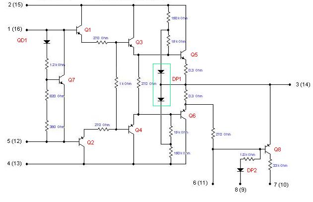

From the info on the link, it looks like the bias for the output stage changes with the signal level. The idea is that the bias level is low when the signal is low, and operates in class A. When the signal level increases, normally it would move into class B. Here they use a microprocessor to (predict?) that more oomph is needed, so the current is increased to cope with the demand, and the output stage remains in class A. In this way they can keep the amp cooler than one that is (dare I say it?) pure class A.

My dad owns a Technics SU-V8 and from what I recall the biasing circuity is designed so that neither output transistor turns off (as class A) although the biasing is not the same as class A.
When the output swings from positive to negative for instance the transistor does not switch off, but stays at a preset DC bias point. The same is true for the other transistor when the output swings from negative to positive.
This way neither transistor passes through the nasty <~0.7V Vbe region. The transition between following the input and staying at the bias point is non-linear, if memory serves, so as to reduce switching-like harmonics.
I'll try and dig out the schematics and scan something as a picture would help explain what I mean.

annex666 is on the right track
new class A is an innovative bias circuit that keeps the output transistors in the ready state, eliminating crossover distortion, though keeping idling current low in order for more efficiency
- some models had computer drive which had an onboard microprocessor controling Icq of the output stage based on thermal and signal parametrics.

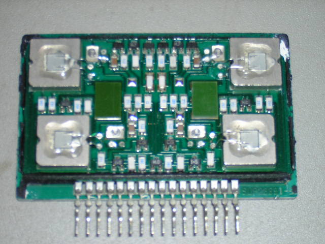

not all were fully discreete and in fact some of the best sounding werent... (SU-V4X) - the SVI Hybrid ICs were infact excellent (now before the solid state buffs groan `bout the ICs - a few things bout them) Being a Hybrid IC they're infact discreete components on 1 substrate - much like the STK series BUT! better than the STK, the SVI features Complimentary Symmetry & all the resistors are ALL SMD rather than the film resistors in STK
http://www.geocities.com/technicshifi/SVI2004A.JPG a typical output stage design of Technics
a look at the internals

It should be recognized that bias circuits that prevent the "other" transistor from turning off in an otherwise class AB amplifier can improve the sound a bit by mitigating some of the switching distortion. HOWEVER, this is not class A and DOES NOT eliminate static crossover distortion.
Static crossover distortion is caused when the net transconductance of the output stage changes as the signal-handling is transferred from one device, through a sharing region, then to the other device.
In Class A, both the upper and lower devices are contributing roughly the same transconductance to the signal path through the entire signal swing. Merely preventing one transistor from turning off does NOT prevent its transconductance contribution from going very small or to zero.
Another very important point about true class A is that the rail current drawn by the power transistors is largely sinusoidal (when a sinusoid is applied), as opposed to a nasty half-wave-rectified waveform. Such nasty current waveforms running around in a class AB amplifier, if not dealt with carefully, can harm the sonics. These quasi-class-A non-switching gizmos still largely have those nasty nonlinear currents running around.
Finally, there is dynamic crossover distortion, where the output transistors are unable to change their current fast enough to follow the signal, often as a result of too low base suckout current and/or too low ft. The non-switching adaptive bias circuits that in a static sense do not permit an output transistor to turn off do not necessarily eliminate this form of crossover distortion either.
