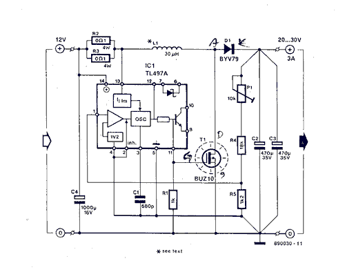

I have built this DC-DC convereter,and it´s working fine,but what if I want say 40volts/1.5 A,can I use a larger inductor for that?
And the switching frek is 16Khz I can hear it when I use it for an amp,can I use a LC or a RC filter?What values should that be?

I am using a IRF830 instead of a BUZ 10,and and at low volume on the amp,it is 30 volts,but when i turn the volume up the voltage drops to say 12v,like the input volt.I will order a Buz 10 and try if it gets better. The amp is loaded with 3 ohms (2x40watts ic bridge amp)maybe the load is to low,and I wil try to
lower the osc cap for higher frekvency.will the current output get lower with higher frekvency?

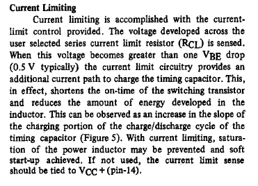

I don't think that the capacitor will affect the current output. That appnote I posted has the formula for peak current as Ipeak=2*Iload*(Vout/Vin). In your case that would be Ipeak=2*3*(30/12)=15Amps. So you need to be sure you have a pretty fat transisitor in there. Looks like it is supposed to a high power bjt, maybe something like ON Semi 2N3772. Not sure exactly what will work there.
Also, your current limiting resistor appears to be the two .1 ohm resistors in parallel, giving .05 ohms. The formula for current limiting from that appnote is 0.5/(Ipeak) . (At least that is what it looks like to me, on page 14) that means you are limiting current at 10amps. Either add another .1ohm in parallel to give you 15 amps, or just get rid of them and connect the two pins together, giving no current limiting. (Altho you run the risk of letting out some smoke i suppose)
I think (hope?) that the reason your output is dropping to 12 volts is primarily because of the current limiting resistors. Before you replace your exsiting transistor, play with these values a bit, and if that doesn't work, then get a new transistor.
The resistors are used to limit the current to the load. I think they could be usefull, but at least for testing purposes can be omitted.
Also, the datasheet shows a bjt rather than a mosfet for the external transistor, not sure if that is a problem?
As far as the original question, (40volts @ 1.5 amps) the datasheet states maximum output voltage of 35 volts, recommended maximum of 30 volts. The inductor size is easy to calculate from the formulas on the datasheet or the appnote.

From the appnote, the section on the current limiting resistor:

Changed CT to 220pf it improved the soudquality,but i could still hear some switch frekqvensy in one chanel.When i touched the leads on the trasistor the switch sound dissapeared,and after a few minutes the convetrer stopped working,the out put was only 12v.Could the sound com from to long cables to the transitor,they are about4-5 cm.
