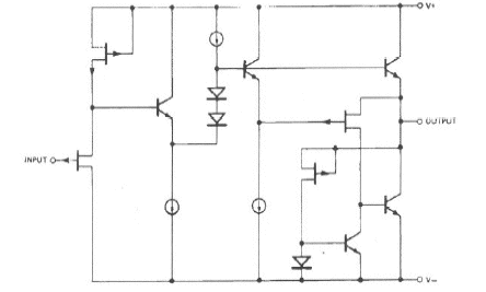

Folks that miss the BUF03 could always try making your own. It might be an interesting alternative to the various diamond buffer designs going on right now.
You can view the obsolete datasheet available still at Analog's website.
Here's the simplified schematic:
The real question is who will be first with the PC board? 😀
