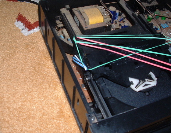

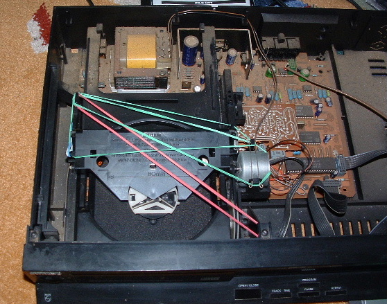

Just thought i'd share my new cd player with everyone.
I got it cheap (£17 inc deleivery), its a Philips 471.
I already have one and bought this for spares and possibly to test some mods on without breaking my better one. Also possibly to steal parts to make a 1541 dac.
Anyway when i put a cd in it sounded pretty good, cdr's wouldnt play. And what a noise from the spindle!!!
Cd ejected no scratches so opened it up.
There was a spring missing from the clamp mechanism.
A rubber band job has fixed it, I also added some more bands to help push the clamp down a little tighter. Blue band is where the spring was. others pull the mechanism together - it seems to calm some vibrations noises. Dont put too many on or the mechanism cant come up when u want eject.
Looking at the lense it was misty! Suprised it played anything! So i put a cleaner disc through it and it came up great, now plays recordables
(I love smash Icons!)
It now sounds better than my other 471, not sure if its the clamping force stopping virbation ? a slightly better DAC chip (maybe a different year or something) OR maybe its the extra dust - check it out 😱
Anyway though i'd post it in case some other owners benefit .

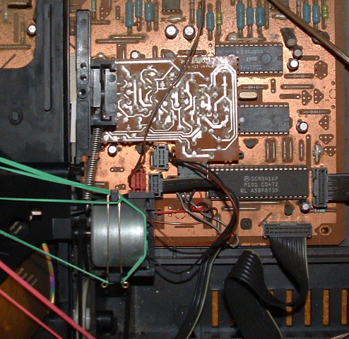

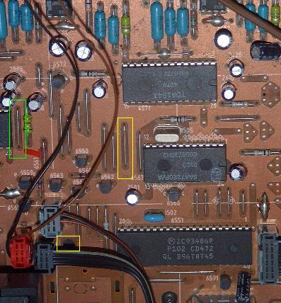

Hi!
I just noticed - im not home yet but i messed up my pics.
The third pic is my first cleaner 471 and you easily see it doesnt have the extra board over the chips 😕
Im sure its my older as theres no dust either.
Compare pics 2 to 3
More later ...
Compare pics 2 to 3
More later ...

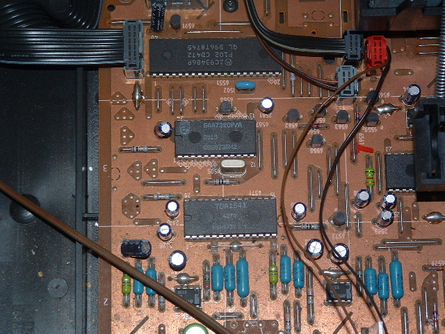

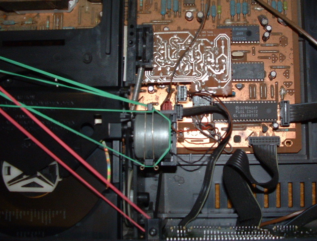

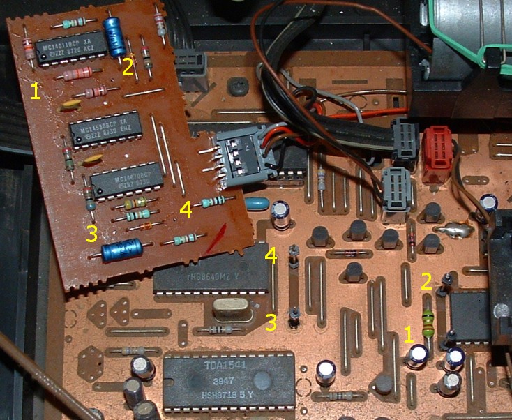

Well I had a look
If you look in the image below in the big yellow box there is a link, this link isnt present and two pins go from the main board to the daughter board(what ever it is).
I also suspect the same where the green box is but i cant see that as clearly.
The daughter also has a four wire connector on the end, its grey in the middle big, located top right of the draw opening motor.
Two wires go to the board clearly, perhaps power, another two go thru the hole to the back of the board, ive highlited the hold in yellow.
I cant see where the wires go to behind the board.
Im guessing this is a mod but its hard to tell, it might be a fix to solve a problem that occurred but this seems strange.
There looks like there are 3 IC's of some sort on this board, just because there 3 arrays of pins.
Anyway here's the pics.
Anyone want to guess what i was listening too, and it was spinning! and it sounds superb!
Anyone have any idea whats going on here ?

The link in the yellow box is ground.
The one in the green box connects the microprocesser with the trayswitch I think.
Brianuk,
if you could post a picture of the component side of this little pcb,it would be helpful.
To me,it does not look like a repair.
On the top right it is just a number, not a word to give any clue - to me anyway.

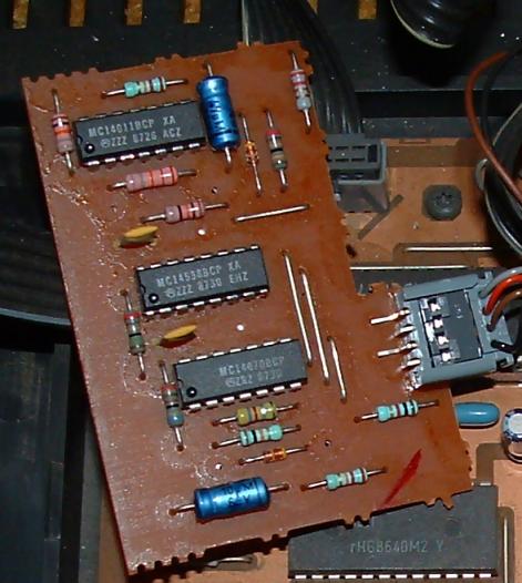

Right then,
I have desoldered it, flipped it over and taken some closeups.
The chips appear to be AND and OR logic gates, I think the middle one had some sort of time in it.
Seems to be boring to me and nothing to do with sound - I had hoped it was remote mod
doesnt seem like it 😕
Ive marked up where it connects to the main board, other then the four wires it has too.
Anyone have a schematic ?
Thanks for all your help, Brian
