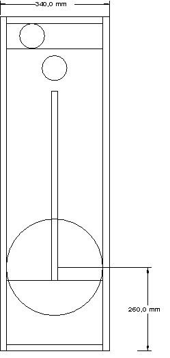

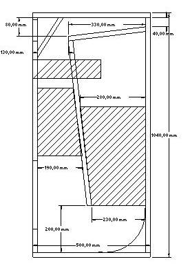

As i´m a bit oldfasioned on drawings, first paper, pen, ruler and the old TI and then the cad drawing i´ll need this weekend before posting anything.
Will supply all drawings and photos as this will be adaptable to other drivers.
No, owned/hotrodded a few in what some say was a misspent youth though.
Youth is ment to be unwisely spent, otherwise, we would have been made accountants right after high school.
You're welcome! I guess the published specs were 'close enough' then. Pity these drivers are no longer available, they modeled really nice, and from your remarks, perform to match.
Yeah, I never let work get in the way of my hobbies. 😉 I could have worked harder at making money, but I wouldn't have had as much fun or appreciate/enjoy what I would have bought nearly as much as making/tweaking things.
GM
Starting with this,
Lenght is according to Your calculations, GM, but volume a bit smaller. JBL speakershop has f3 at 16,6 Hz for this which i find an ok compromise. Not totaly shure about portlenght yet but i´ll go the trial and error road.

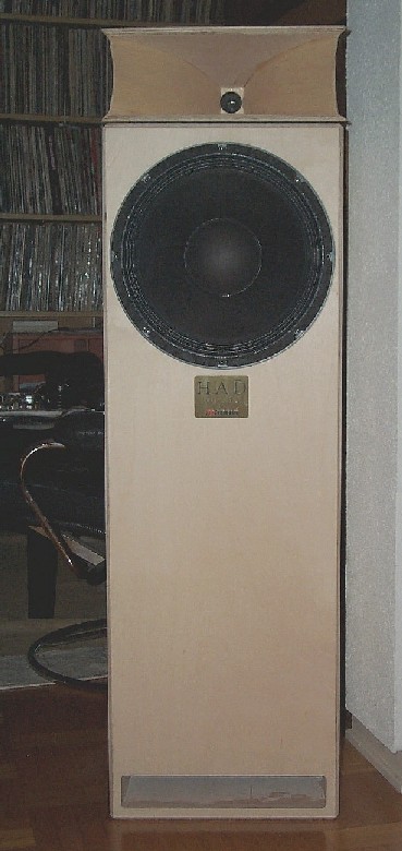

Long time no seat
So what happened? While fiddling and testing with the prototype pipes the RCF units lying on the floor, the Cat decides to eat the the foam surrounds. No, honnestly, i did not kill the cat, she´s still around here, destroying something else. I declared her a "non-friend" and refused to feed her for several hours.
So! I decided to venture along another route. As GM says - loud is beatifull, and cats don´t eat cloth surrounds. Went the efficiency way and used an Eminence Kappa Pro 12 in a pretty traditional TQWT. Used for a while now, most of the time driven by an old Mark Levinson ML11. It does´nt get much more fun than this. Top is B&C DE900 1,4" driver in wood horn powered by Zen V5 ( when not burned out) or homebreew EL34 class A push-pull stage, so-so, good opt´s though.
