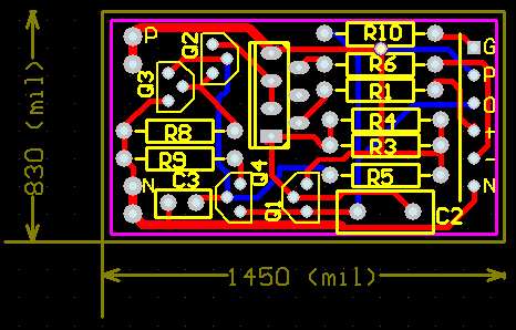

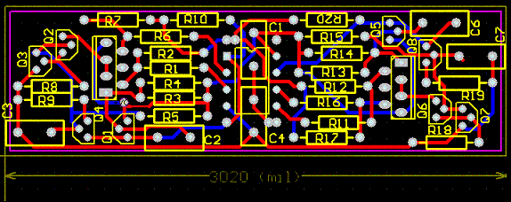

Here is a potential layout for moamp's discrete opamp, designed to simulate a standard dual opamp. The idea is to use it with Jen's Active Filter 2 board. Of course, it could also be used in any other circuit as an opamp replacement.
There will likely be a group buy of these boards
You can see that the design will plug in Jen's board in DIP8, plus the two grounds into the bypass capactor pads. I have also laid it out to be used in a DIP12 pad for use in other designs. I'm not sure how critical the ground connections are as long as the host circuit has the appropriate components... 😕
Please let me know any comments on the layout so that it can be improved. Thanks!

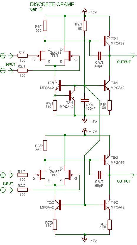

Here is the corresponding schematic. It should match moamp's schematic . I included R10.
The other half merely has the resistor numbers + 10.
Warning! All of the 3-pin transistors are backwards in the schematic. This is because my schematic library had the pinouts backwards and I was too lazy to create new models. They should be correct on the PCB.
tiroth said:Here is a potential layout for moamp's discrete opamp, designed to simulate a standard dual opamp. The idea is to use it with Jen's Active Filter 2 board.

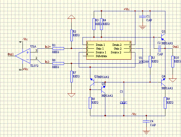

If the discrete opamp is going to be used in Jens's board, some parts can be left out. R10 is necessary for DC stability and can be soldered directly onto the bottom side of the motherboard (from pins 1 and 7 to the ground), and an additional ground wire isn't necessary.

has anyone thought about making this thing pin-compatible with the standard dip8 dual opamps?
For example, you can break up the board into two pieces, each containing one opamps. On one side of the boards, you will have your input pins and output pin, and insirt each board into one bank of a dip8 socket so that they will be drop in replacement of typical dip8 opamps.
Wouldn't that make this thing more marketable?
and if you used smd parts, 🙂
That's an interesting idea. You'd have to link the two halves though via wires in order to tap the bipolar supplies out of the opamps. It would probably make it compatible with more uses.
Thanks for the insight moamps. I will take it into consideration and simplify the layout further.

Okay! This is much cleaner. Thanks again to moamps and millwood.
This can be used as a 6-pin SIP with ground, or two together can be linked by the pads on the left side and plug into a standard dual opamp pad.
For use as DIP8, the left half would use leads from 'O'ut through 'N'egative. The right half would use 'P'lus through -IN. Ground could be left unconnected if R10 were soldered to the PCB.
Any comments? BDP, where do you want the adjustable resistor?

Thanks for the feedback! I will try to incorporate both suggestions. The screw idea will take up some considerable real estate because of the lateral offset between the boards, but it is a good idea and I'll try to fit it in.

Ouch, that is what you get for rushing at night. 😉 An easy fix. Thanks!MBK said:the order of standard DIP 8 op amp pins is different from your PCB, it is "out, (-)in, (+)in", see pic.
Actually, I think it is simpler routing broken up. And it has a smaller footprint at the expense of vertical height...which means it is more likely to fit into pre-existing designs. 🙂I am not sure if it's a good idea to break up the board.
Well, it was never intended to be a DIP8 single opamp replacement. The idea was more that DIYers could feel free to, like moamps, design their boards around the SIP6 form factor if they wanted single discrete opamps.And a drop in for a *single* op amp package would still have to be DIP 8
Virtually none, I think, with 2SK389. The offset adjust trimmer should come in handy for designs using standard (single) JFETs.I wonder though how much offset you would get anyway with a FET input design
Thanks for your input.
Updated PCB, with trimmer and screw pads.
The screw pads accommadate a 2-56 screw with 5/32" diameter spacer. R8 was moved to the back, and if you use the optional screw attachment R9 moves the back on the left half and must be soldered after the screw is attached on the right. Pretty easy. I didn't want to increase the board size (and cost) to those who don't need it.
