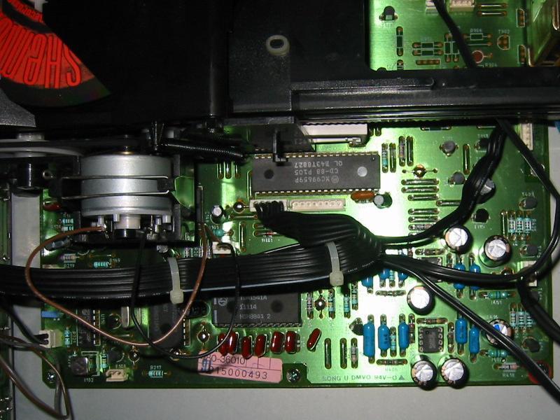

Can the muting transistors be seen in this photo, if so can you point them out? Excuse my electronics ignorance, but will I need to bridge where they were or just pull it and done? :smash:
BTW, I ordered opa2134 & opa2604 samples (free, yay!) along with a few from analog devices to try out...
You can remove them, they are the small black half moon transistors (3 prong) closest to the output rca's. there should be 4 of them just like shown here. They can be desoldered or clipped off. I do not have the map of the 965 though.
Stephan
Thank you psonic I have just desoldered it,I'm realy surprisely,great improvement to quality sound,this is the better tweaking I never done.More details and clean,and much real sound it's difficult to say in word.

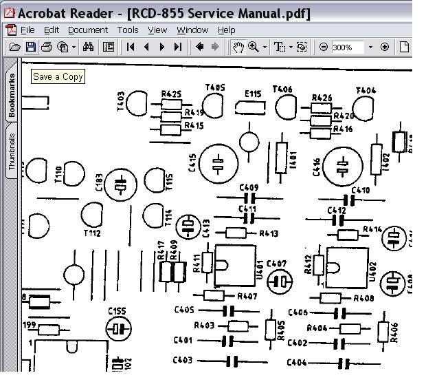

Also, anyone with a schematic please email it to me - thanking you in advance.
