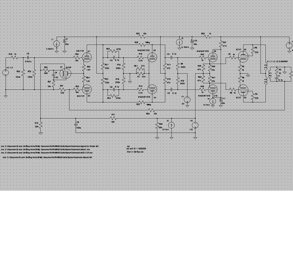

There is method in my madness and it's based on Norman Koren's "The Emorer's New Amplifier" article. He built a PP amp using 4x6650 in triode mode, class AB2. He claims it is sonically excellent and more linear than UL. His enthusiasm has rubbed off on me to a certain extent, because I would like to get the extra power without incurring the pentode's higher order harmonic distortion and high OP impedance.
Modelled in LTspice, the AB2 arrangement seems to be capable of delivering up to 30w before cutoff, which is twice the power of AB1. I don't intend driving it to high such levels on a continuous basis but I would like to have the headroom. It wouldn't cost me anything except effort, since I already have the necessary parts to insert a cf driver where needed. I reckon a 6SN7 would have enough grunt for this.
I have already tried a pure pentode arrangement but I couldn't get satisfactory bass (too boomy), which I suspect is because I couldn't pile on enough NFB to increase the damping factor to a realistic level. UL is out, unless I invest in a new pair of OPTs, which I'd like to do when I can afford it (maybe Lundahl).
I'll attempt to attach the LTspice schematic that I used to model the planned amp, which is only for one channel. Please note that a number of current sinks are included to represent the load impose by the other channel.

Starting with the "obvious": When the grid goes positive, its impedance drops from infinity to about 1K ohms very abruptly. If the driver's gain falls off at 1K load, distortion is large. As a first approximation, driver source impedance should be zero. Actually, since Gm is rising and Rg falls somewhat slowly, lowest THD may be with a source of 50Ω-100Ω.
Another way to look at it: negative-grid tube is an FET. But positive-grid, it is a BJT: plate current is approximately proportional to grid current, the "Beta" starts at not much more than 10 and soon falls close to unity. It is entirely possible to push a tube with more grid current than plate current. That actually works in RF where tuned circuits transform impedances and store energy. In untuned amplifiers, big grid current is wasteful and there is usually a better way.
The implication of a low "Beta" is that for maximum power and maximum efficiency you should run the output stage at HIGH voltage, and the driver from a lower separate supply.
BTW: most SPICE tube models have very poor modeling of grid current. Some omit it entirely. Some put in a silicon diode and a 1K resistor: this gives you a flat-topped hint if you thought you were not running grid current, but is not a good approximation of the real performance.
It is very hard to make a 100Ω source with tubes. (And you sure need to lose the 1K grid resistors.
I've seen it done with cathode follower 6SN7 but with both sides coupled with a center-tapped choke, which doubles the drive current and halves the output impedance (since only one of the grids is low-Z at a time). And that was a high-power P.A. application where a little mud on peaks was a fair trade for a lower price (or higher profit).
A very traditional way to go AB2, back when we HAD to slap grid current to get to a Watt, was to use a third "output tube" as the driver, working through a 3:1CT step-down transformer.
Trying to drive 1K loads to 10V-30V, i.e. 10mA-30mA peak drive current, from a 300V supply, through tubes of ~6K plate impedance, is doing things the hard way.

Ah, but what is the worst that can happen? You build it, it isn't sweet or isn't reliable, you re-make it as a conventional amp. No big deal. And the best-case is: it works sweet and well, you come back here and rub our noses in it.
Just don't put much faith in the models. You have to build it and see. While I doubt you have any worry about grid-melt with unclipped speech/music, be cautious in full-power testing. Have strategic burn-out resistors to protect the transformers against tube shorts.

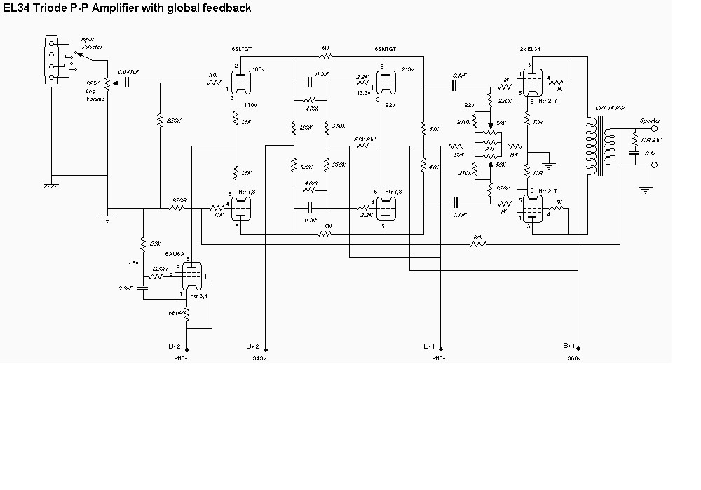

Wow! Thanks very much for all the responses! My original question was mainly concerned with whether the EL34 could tolerate some grid current, but all the other advice is gratefully received too.
On balance, having read what people have said, I think I'll give AB2 a miss. (Chicken!!) The modeling with LTspice has been fun but, if it's not going to give me a credible result for grid current, then the only way to find the real answer would be to build it. That would involve making extra holes in the chassis for the additional 6SN7, plus the wiring. That's a lot of work for little or no gain (no pun intended).
I already have a negative supply in place. However, it has to supply two channels and wouldn't tolerate more than about 28mA, since it consists of a 50v 100mA winding with a voltage doubler, to give ~110v; from people's comments, I would probably need more than this, especially if I have to use a beefier driver than the 6SN7.
Perhaps the best approach for me, if I need more headroom and don't want to use the EL34s as nature intended (pentode or UL), would be to do what Gingertube has done, i.e. stay with AB1 and add another pair of EL34, triode-strapped, in parallel. My OPTs are big enough to tolerate this, I believe, and I could use the 8 ohm tap for my 8 ohm speakers instead of the 4 ohm tap (which I'm currently doing, to get 7k plate-to-plate load). Just have to find another power tranny!
For anyone interested, I attach the schematic of my present amp, which sounds OK to me. ( Any comments in this circuit would also be gratefully received).

Ray,
If you want to have a quick and dirty trial of AB2 then use SY's trick and use a IRF820 as a source follower. No hacking up your chassis for a new tube hole or heater supplies to worry about. Sonically it will be VERY close to what you'd achieve with a tube cathode follower, so if you liked it you could convert to tube cathode follower afterward. You've already got a suitable negative rail so its really just one MOSFET and one resistor to add to each channel.
BTW my 4 x EL34 Triode Strapped parallel push pull is into about 2400 Ohms Raa (Plitron VDV-2100 with nominal 6 Ohm speakers on the 5 Ohms secondary). These monoblocks are working quite well with a wimpy front end - ECC99 as common cathode with direct coupled concertina. I'm getting -3dB top at 105kHz at 10 Watts out, despite "inadequate?" drive of the output tube grid capacitances.

> if I need more headroom .... stay with AB1 and add another pair of EL34
Or stop fooling with the small-beer EL34, and use the big-bottle 6550. It is a very powerful pentode and a mighty fine triode. While the EL34 can do amazing things, you have to be heroic with a pair of EL34 to make half what a pair of 6550 will do. I think heater consumption will be less.
