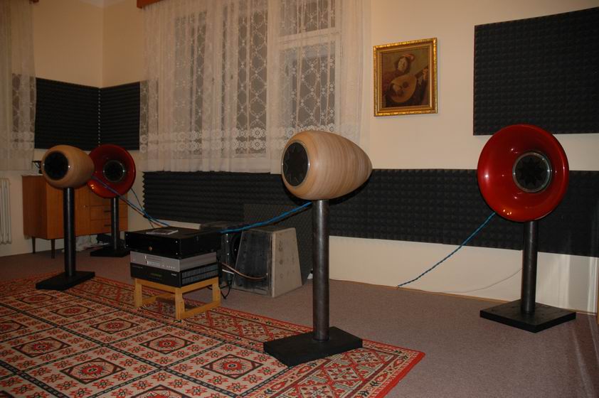

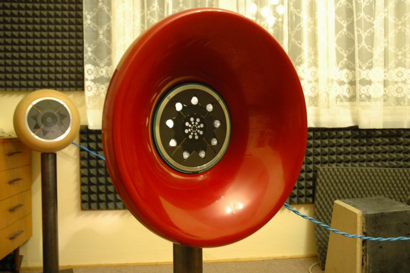

Hallo,
I have decided to introduce one of my diy projects with Manger sound transducer (MSW). The excellence of this wide-range driver as a direct radiator is well known these days. However I have not found any frontloaded loudspeaker utilizing this driver. There are just some projects of backloaded horns as Basstuba on the internet.
According to Bert Doppenberg the Manger transducer is too compliant for satisfactory frontloading. My results show very good suitability for front horns.
I have listened to Oris 150 / AER BD 3 combination several times. I also listened to Hedlund horn / MK I combination. There is no doubt these are great speakers. The contribution of front loading is absolutely clear to me. It changes the sound from dry to liquid, from sterile to colorful, from synthetic to live. But the front horn must be extremely acoustically dead. If not made properly, the sound is one of the worst you can diy.
This was my case, my friend Coffee (I owe a great deal to him) made me near tractrix front horn (something like Oris 250) but from 3 mm of laminate (fiberglass). I installed MSW into those horns and played music without any passive filter. The sound was very colored and fatiguing. The exact opposite of what the Manger sound like as a direct radiator. In addition it had decreasing response in the highs (I presumed it).
It was necessary to dampen the rear side of the horn and to reduce the horn length. I made it with small steps. Now the horns are damped by about 10 mm of bitumen-rubber material (asphaltic putty). This material will be difficult to paint, but it is acoustically dead. Horn length is reduced to about 160 mm. Horn throat diameter is 204 mm. Maximum horn diameter is 520 mm. There is no back chamber (my goal has always been to find the best dipolar application of MSW because there is nothing like ideal back chamber).
How is the sound? It has typical neutral MSW sound, but with all the advantages of front loading (more detail, more dynamics, more body, more space). Coloration is negligible. This is the pair of large Manger transducers, capable of very detailed soundstage.
Transmission range is from 40 Hz to 40 kHz and balanced output is from 200 Hz to 25 kHz.
I caught myself enjoying Faithless or Chemical Brothers without using bass drivers. Certainly for classical or rock music the bass drivers are essential.

I have been doing more experimentation with those horns. It seems possible to balance bass output as properly as it will no more need any additional bass system (at least in my 55 m3 listening room). Short back chamber enables this without coloration.
It is a must to weight the MSW driver down because of its relatively low mass. I attached six strong neodymium magnets (N50) to the motor as a weighting. It does not affect sensitivity and sounds better in extreme dynamic passages. I do not know if this is firstly due to the higher mass or due to the relatively stabilized magnetic flux in air gar but it works. Later I will probably use massive iron flange instead of those magnets.

I reduced the horn length to 135 mm. This sounds most open at highs (as if it was in large open baffle). The drop-like enclosure sounds more like normal box enclosure (baffle step is around 350 Hz).
I have tried also various open baffles, which are all superb with MSW (the larger the better), but the zerobox head with 3 MSW is my future favourite in every aspect (huge price) and for the low price the shallow front horn is excellent solution.
