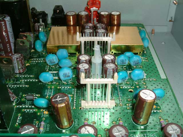

(I/V filter caps?????!!!)
2211, 2212, 2715, 2716, 2717, 2718, 2719, 2720, 2721, 2722, 2723, 2724, 2725, 2726 - and 2213, 2214, 2217, 2218
These are blue and marked "101J 100" in the OSE.
In the KI they are green, smaller, and marked "Audio 101J N" in the KI.
Can anyone assist identifying what type of capacitors these are??
I will attempt to post photos.
:xeye:
Cheers
Attached is a photo of the capacitors in the OSE player.

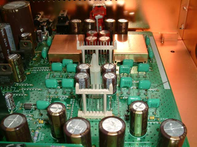

Attached is a photo of the capacitors in the KI player.
Can anyone please assist with indentifying the difference in types??
Cheers!
Replacing these with Silver Mica types appears to be popular, although there seems to be some conflicts in opinion. I'll see what I can source, and make my own judgement 😉

Pretty much most of what is mentioned come to think of it. Not sure what those caps are - mylar filter caps? And higher grade polyproplylene in the KI? Or somesuch. probably completely wrong!

RE: (I/V filter caps?????!!!)
They are the green ones in both of mine. Two possibilities:
1. They ran short of the blue ones when they built my ose and substituted with stock of green ones.
2. both blue and green are of a similar specification and they use whatever they can get (duel sourcing).:drink:
