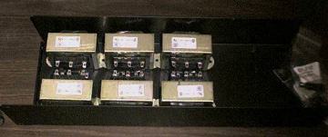

For example, I'm right at the beginning. I've got a nice metal case and a transformer and I need to mount the transformer in the case... and I'm stuck. Do I go out and buy appropriate sized nuts and bolts, drill holes in the bottom of the case and just bolt if straight down flush to the bottom of the case or should the transformer be raised slighty and if so how? A washer, a stack of washers??? I hope this imparts enough of my frustration and uselessness here so you might be able to help and I'm sorry if this is a little off topic, thanks.

Now this is something I can relate to, being a klutz who is still learning.
Mounting things in an enclosure:
First you need some feet. This is because effect the aestheics if you put them in odd places and once put in place they add a constraint to where anything else can go. I like just ordinary rubber feet - either stick on or screw on. (You can spend $100 for gold plated spikes if you like but the idea is the same.)
If you are not hyper fastidious like the TV detecive "Monk", lay the components out in postions that make sense. Look for mounting holes in the components. Some things like transformers and especially bridge rectifiers can be attached directly to the floor of the case. PCB shoild use short spacers. Here is an ecample from the digikey catalog- http://www.keyelco.com/kec/pdfs/p44.pdf
(I find 4-40 thread sixed nuts, bolts etc. are the most generally useful for almost everything.) You only need the long enough so that the bottom of the PCB stands no chance of contacting the case.
I use ordinary "pan head" bolts or "machine screws" that come up from below the enclosure. I don't usually worry about aesthetics since you can't normally see these. If you need a flush surface and the sheet metal is aluminum here is a cheap trick: find a washer whose inside diameter is about the same as the diameter of a "flat head" machine screw. Drill the hole. Run the screw in from the outside. Place 1 or 2 of the washers over the screww on the inside. Put a nut on the screw and tighten and keep tightening untill the sheet metal is deformed enough that the flat head is flush with the surface. This works best with 2-56 and 4-40 screws; larger ones are a bit touchy. Practice first on a piece of scrap metal. Throw away the nut and screw as they are often damaged by the process and use fresh ones for rhe actual mounting.
Cutting large round holes. As the diameter of a hole gets bigger than than the thickness of the sheet metal, it gets harder and harder to drill a nice round hole. There is a gadget called a "Unibit". I thought these were just snakoil but they really work for making nice clean large diameter holes in sheet aluminum. Pricey but worth it if you make very many holes.
Rectandular holes: avoid if possible. If you can't avoid, try a "nibbler" plus a Dremel (or Craftmab's equivalent). It takes a few to get the hang of it.
"D" shaped holes. Either spend a load of money on a punch or fogeaboudit! I hav'nt made one yet that looks decent.
Finish: If you have little money to spare you can get a real nice paint job from you local body shop. DIY painting is possible but takes patience. Satin or brushed finishes are doable. You need wet and dry (get several grade of increasinf fineness) emery paper soap and water. Get a sandinf block. Decide which way the grain should run and start sanding after dipping the paper in soapy water. Make all you strokes in one direction only. Each stoke goes from edge to edge. Work slowly. Change paper frequently and move up step by step to finer grade until you like what you see. When done you can leave it as is or if you want to protect it from fingerprints and oxydation do a search on this forum foe "alodine". Anodyne may be possible if you have a shop in your area.
General rule for metal: measure very carefully. The take a deep breath, stretch, walk around the room and remeasure - repeat. Only the do you cut or drill. Careful measurement is really, really key with metal.
Second general rule: use a bigger enclosure than you think you need. It's starts getting really cramped after a couple of components are mounted.
General rule three: decide up front where the wires are going and be sure your layout won't block you from access to terminal block or solder tabs that you will need to get at. This is the audio diy equivalent of painting yourself into a corner!
