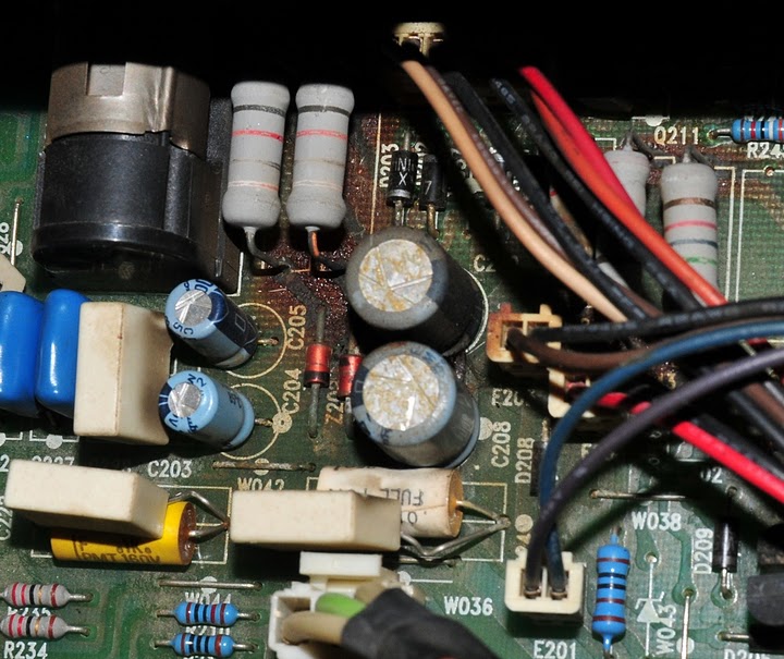

Hi I am new to this interesting forum, I recently purchased the HCA 2200 MkII, can you be more specific about the " caps that seem 'tacked on' or paralleled with other similar caps. Just remove them, except for one 0.1 uf or so cap in each board location" and what about the 47K resistors where are they, I am an electronic engineear my self so I think I can make some mods my self. Please also look at the attached pictures, can you tell me what is wrong with this resistors....

Did you say you are an engineer.. you ask all the wrong questions. Questions an ee would not need to ask

Vacuum it out first! Clean the contacts, both input and output. Finally, if you see a lot of 'extra' film caps across the main power caps, you can cut the majority of them out.
Thank you very much for the reply, I found the schematic online and from my understanding one must remove the film caps that are parallel to the main power caps, but the majority?? how many do I leave in place?? and an other thought if we decrease the value of the feedback resistors (47K) wouldn't the frequency response be increased ?? also does it mutters if the Holco is higher wattage (from my understanding no).

wattage for the 47k makes no difference (1w) say, I believe John was suggesting the H2 version. I just order the 47K from Texas Components. Changing the feedback value is not a good idea, tried it and did not get good results but you can do whatever you like. I would just remove the bypass polystyrene's and leave one for each. As far as the power supply bypass I found it best to add all the values that are in place and install one high quality polypropylene. I get very good results with the multicap PPMFX or better. I would take a really good look at the ripple under a load and make sure you main caps are still good. I have not seen a single one of the Richie caps they used in good shape. Element 14 has the a great CD cap. I usually use the 22,000uf 80v. Fitting in larger caps are not a option or at least it's more of a mess to fit and make no difference.
