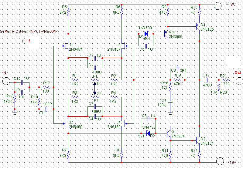

For whom would be interested, I have designed and built about 10 years ago a simple (8 transistors) symetric j-fet (2n5457, 2n5460) input pre-amp that sounded very clean and detailed. It had a gain of 5.

symetric j-fet input pre-amp
Here it is
Q4 and Q2 are medium power transistor since the DC output current is about 20 ma. Some peoples may critic the 470uf output cap but at that time I was very precautious so in case of output failure no DC voltage would apprear at the power amp input...
Here it is

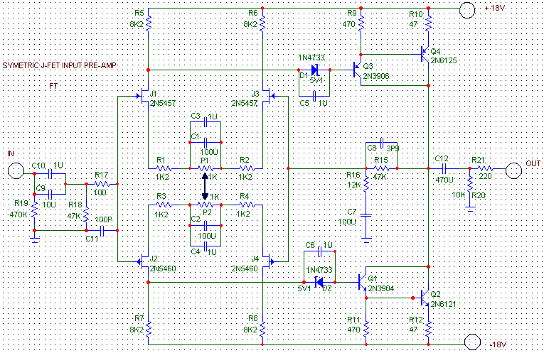

Re: symetric j-fet input pre-amp
I redrawn by hand written circuit with microcap and made a mistake, sorry. See the C1 to C4 caps connection.
fab said:Here it is
