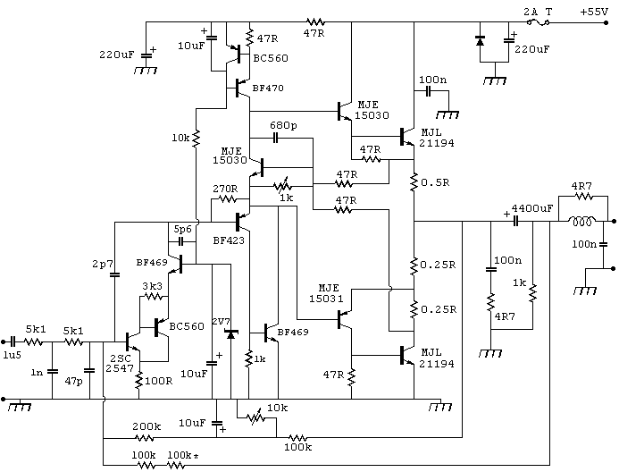

May I draw attention of the respected diyers to a new amp by Mr. Renardson
http://www.angelfire.com/ab3/mjramp/newamp2.html
The PCB will be available soon, if you need it, drop a note to Mr. Renardson

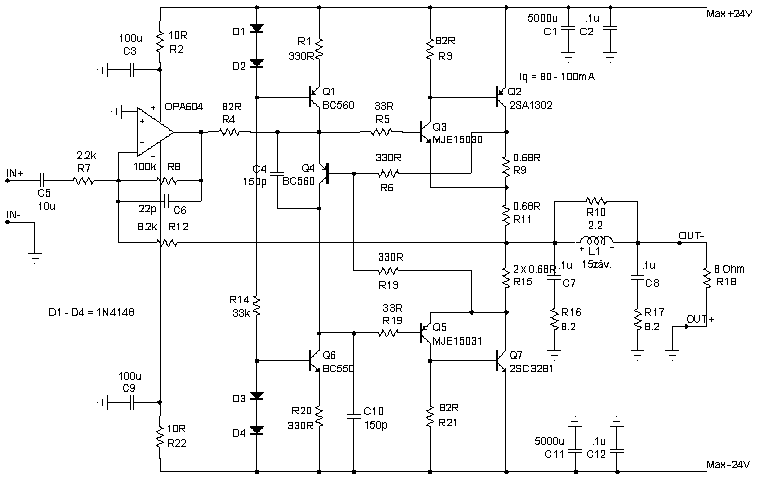

another amp
And another amp based on the same principles from Czech
http://petrh.czweb.org/renardson.php

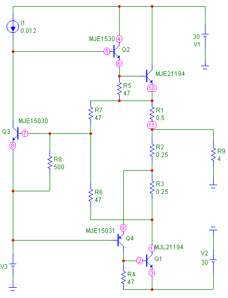

There is a cross-over distortion error correction in both schematics, listenning experience would be appreciated.
PMA said:There is a cross-over distortion error correction in both schematics, listenning experience would be appreciated.
I am curious about it too, especially why R9/11/15 are set up that particular way.

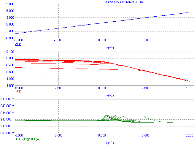

dimitri,
you are probably using MicroCap7. Have you tried harmonic analysis? I would like to know whether there are or not higher order harmonics, and of what value.
Pavel
Pavel
Sorry for my slip,
instead "current through nonswitching negative (lower) output device"
please read "current through nonswitching positive (upper) output device"
Pavel, yes, it is uC7, I have not tried harmonic analysis, don't trust simulators... But it is not a problem

I got several comments from the board members that the amp will have low disto only with active load, and with reactive loads it will be the same as ordinary class B.
Now Mr Renardson checked the 20kHz distortion with a parallel capacitance, and added the result to the test page. The distortion was higher than before, but the load impedance is lower, so some increase was expected, but there is no serious crossover problem.
Re: another amp
Reminds me of the bias circuit for the A40.
dimitri said:And another amp based on the same principles from Czech
this one ?Reminds me of the bias circuit for the A40.
https://www.firstwatt.com/pdf/art_a40.pdf
