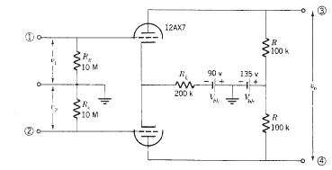

Can someone please supply me with equations for gain and Zout for this basic circuit? There is an article[http://www.tubecad.com/october99/page9.html] on TubeCAD which gives equations, but their usage of the || notation is unknown to me, and I don't understand their gain equation.
I'm actually shooting for a unity gain buffer, so feedback usage would be extensive. Probably a 12au7/e88cc tube. I'm also interested in a balanced circuit such as the one below. It appears that the cathodes are simply tied together to form a difference amplifier from a plate follower.

The gain of that circuit is around 50. But it's hard to tell, with the values given, the tubes are barely turned on. They are operated in a very non-linear portion of their characteristics.
The plate currents are an anemic 0.225mA. First thing you need to do is increase the plate supply to 300V or 400V. Then change the standing current to 1mA or more. Try to get about 200V on the plate. The difference in sound is night and day.
You could add feedback to drop gain down to unity, but why not just use a cathode follower?

The schematic is right out of a textbook; I didn't intend to use the circuit values as-is. Is there a similar circuit that can be built using cathode followers? What about balanced to single-ended conversion?

Don't get me wrong, the circuit topology you show is an excellent one - I use it in my "Trumpet" phono stage.
The easy way to go from balanced to single-ended is to just ignore one of the signals. Of course, to maintain CMRR a differential pair is a great way to go. You can take one of the plate signals to drive a cathode follower. From this buffered output, you can then apply feedback to the input. But be careful, ac-coupled feedback will just lead to a huge rise in gain at low frequencies (usually infrasonic). You'll need to balance it will a low pass filter in the forward path (inside the loop).
tiroth,
looking very puzzled here, and wondering noone else refused to swallow the term "plate follower" or "anode follower".
Where i have been brought up, a "follower" is a non-inverting unity gain device, no matter if made from tubes (cathode F), FETs (source F) BJTs (emitter F) or opamps (voltage F).
The correct term for "plate follower" is "common cathode" or "grounded cathode" amplifier stage which is an inverting gain >1 device (see below).
I am speaking up as i do want to shoot at misleading terms which hide misleading concepts. I know that such foggy terms are fervently used in other forums ... and consider them to be mentally infective ...
I presume this term to be picked up elsewhere, so, no personal offense meant 🙂
As to your question, the circuitry you posted is a differntial pair with the R_c (200k) acting as a modest constant current device. The node connecting R_c and both cathodes is acting as a virtual ground. So the equation for the stage's amplification is the one applying for a common cathode stage:
G=µ*(R/R+r_p). In your case R is 100k, µ is 100, r_p is 62k5, so G is theoretically 61.5 as a fixed-bias EC83 with B+ 350V= and R=100k would have (presuming the values i took below and not those from the posted circuit).
After a rough calculation methinks the posted circuit will not work well with those values. I agree with hagtech, not enough quiescent current. 100k for the plate resistors would be ok provided B+ is raised to 350 V=, B- is kept at -90V= and R_c is reduced to 40k5. Quiescent current is then 1.11mA for each tube.
I took the recommended values for the ECC83/12AX7 from my Ratheiser tube manual and took care that the virtual ground of the differential stage is close to real ground. R_c has to drop 90V @ 2.22mA.
For a collection of formulae, i recommend the Radiotron Designer's Handbook 4th ed., it covers all. Available as reprint from Old Colony Sound Lab or as original from ebay auctions.
If one should want to increase this circuit's gain to the tube's open loop gain (µ=100), please replace each plate resistor by a constant current source (CCS). In this case do not replace R_c by a CCS.
But for your unity gain device, please use a cathode follower, it does exactly what you want. And if you need it differntial, use two cathode followers with the differential signal applied earth-free to both grids. Replacing a cathode follower's load resistor by a CCS is strongly recommended, on the bench as well as sonically.
You will need an output coupling device, either coupling cap(s) or another amp stage (possibly DC-coupled) or an output transformer. A pair of differntially used cathode followers having each CF output connected with one end of an output transformer is a truly differential output stage with very low output Z.
Use of CCS as CF "load resistor" is particularly recommended here.

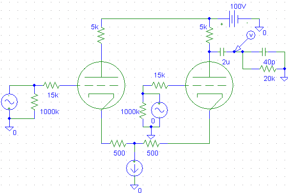

Building on the original "common cathode" amp I put together the following circuit. I think the way I did feedback is wrong; it works, but it reduces my CMRR from a simulated 100dB (no feedback) to about 30dB. (I know the inputs should be AC-coupled in the real world)
Distortion is higher than in the differential circuit; -72dB 2nd, -90dB 3rd versus -90dB 2nd, -110dB 3rd. Is this due to a poor design on my part?

Your diff.amp simulation: if it claims 100db CMRR, it simply hmmmmh... makes glorious but unkeepable promises. 🙂 . I have never seen CMRR of more than 60, maybe 65 dB for diffential tube circuits and if the tubes are poorly matched and/or driven at the wrong operating point, yes, then it drops to 30dB or less.
Referring to your two posted pixes now:
I am no feedback expert, but to me your application of FB looks weird, never seen anything like that. U apply the same AC output-derived signal to both inputs.
I always thought, negative feedback is meant to correct errors, but this only will work if both sides of the circuit are fed with inverted output signal portions, so your NFB2 should be derived from T1, not from T2.
And then, the original circuit had same load resistor for both plates. Methinks this should be maintained, even if u use only one side for the output.
Methinks NFB should be avoided at all. Biased me 🙂 . A differntial pair has outstanding bench performance, no need for correcting via NFB as your figures prove, so why do it? Sounds beautifully, too.
Moreover, you need coupling caps for NFB, messing up sonics. Another reason .... 🙂
U could linearize your long-tailed pair by putting smallish resistors (say, below 1k) between cathode and virtual ground, is u do not need the amplification. Those resistors act as current feedback as they would do in a common cathode amplifier. Transconductance is decreased, transconductance change caused by aging, too. So the influence of (now) poorly matched tubes is decreased too which is mainly a thing of tube aging.

Feedback loop of my posted circuit: ok, this is all wrong. I'll try to work on this. The primary reason for NFB was too much gain in the circuit, which a cathode follower variant would solve. I will probably use low-mu 5687 tubes, but still anything much over unity will likely be not desireable. I also had a problem with distortion in the single-ended variant that was not completely addressed by NFB. As you pointed out, a reasonable balanced topology looks beautiful distortion-wise without feedback, but the gain is too high.
Plate resistor of T1: Neither my text nor Glass audio's circuit (linked above) uses a plate resistor for the input tube. I don't think I fully understand the reasons for this, but since it is basically being operated as a cathode follower there is not strictly a reason for a plate resistor.

Do what Dice45 suggests. Add degeneration resistors between cathodes. If you use low mu tubes (even the 12AU7) and these resistors, the gain can be brought way down. Try aim for 6dB or so.
Regarding the missing plate resistor, sometimes this is done to lower input capacitance. It removes the Miller feedback. On the other hand, I far prefer to keep it. Without identical plate loads, the tubes will be biased at completely different operating points and you will lose the ac balance.

I haven't been entirely slacking off during my hiatus. Here is my current design, balanced in, single ended out, using 5687 tubes. Vp=100V, biased at 10mA. Gain is about 6dB.
I'd like to increase the grid stoppers to 50k to obtain some free HF rolloff, but I don't like the idea of such a large valued resistor in the signal path. Should I really be concerned, though? The simulator says input current is only in the 100nA range.
Bernhard/Hagtech, thanks very much for your suggestion of degeneration. Not only does this avoid some NFB issues, I've found the output also measures much better in terms of THD. Unless anyone has comments, I think I am happy with this design. I appreciate all of the assistance.
For anyone that is following this thread (?) here are some test results (simulations only!!)
