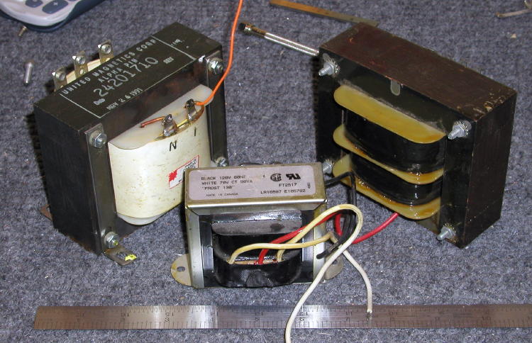

With specified dimensions, it can't be 200VA transformer.
I have exactly same size unit from Frost and it is 90VA, which seems more appropriate for that size (its 30-0-30 VAC BTW).
Well an LM3875 can't pull more then 5A. With a 4ohm load that's what you have at max power. It's about 3A with an 8ohm load.

So you would be better off with a 120va transformer per channel but I think you would have no problems getting this to work.
I have a GC that uses 1 75va per channel, but at normal listening levels only draws 0.3A from each secondary.

Bill Fitzpatrick said:What do you mean 30-0-30? The PE page says it's 20-0-20.
My Frost is like that.
Peter Daniel said:With specified dimensions, it can't be 200VA transformer.
Peter, how sure are you about this? I was always under the impression that the guidelines for rating transformers on dimensions or weight were very broad, like +/- 50% or more (I'm not trying to be argumentative, I know a lot of surplus parts are spec'd by "eye").
Aunkst said:is 20-0-20 at 90va adequate for a LM3875?
The amp will work with that, but you might use separate transformers per channel.
Peter Daniel said:I've seen many transformers, and 200VA can't be that small.
I just happen to have few 200VA rated EI transformers and they are twice as big.
Of course I may be mistaken, but I rather doubt it.
Yeah, I guess I buy that. I have a couple of those that I bought last year from PE. They are slightly larger and heftier than other 100 VA xfrmrs I have, but are dwarfed by the 300 VA units I own. But at $5/each, even using 2/channel looks mighty good, if you can live with the cosmetics.
very well then. Thank you PD. I just ordered 3 of them. one for each channel (left, center, right). I'll post my progress...

I wouldn't see a reason why one of those transformers wouldn't work per channel (it will even work for stereo amp). The only question is how much performance it offers at higher power (and current demands), but for normal use a single TX like this should be fine per channel.
You still need both secondaries (when powering one channel only) as the supply requirement is +/- V.

As to wiring the transformer to your gainclone. power board. Lm3875’s need positive voltage and negative. As well as a reference ground. So this transformer is really perfect for that. You take one secondary and hook that to the AC1 and the other secondary and hook that to the AC2 the center tap will be your ground and that gets hooked to the N.
Do not attempt to wire your transformer for 220 on 110 or try doubling these up if you don’t know what you are doing.

Sorry if last post not clear. I was referring to using a separate xfmr for v+ and v-. By wiring for 220 and running on 110, should give a 20vct sec on each xfmr. By not using ct and wiring 1 xfmr to ac1 and the other xfmr to ac2. should give equivalent to 40vct xfmr. $10 is a lot cheaper than $42+.
To take things a little further, if you wanted to use a separate transformer for each channel it looks like it would be pretty easy to change that dual bridge power PCB into a single bridge one and essentially have 2 rectifying circuits on each power board.

Hook up one secondary to AC1 and the other secondary to N, I would suggest leaving out the 4.7uf capacitor -V1 and -V2 will be your negative DC power rail, and Gnds will be your positive CD power rail. the center tap on the transformer will be your 0v or ground, just hook that wire to your umbilical or to the power ground on the lm3875 PCB

You will also cut your VA rating in 1/2 since the amperage that the transformer can pass will be the same, Just that you cut the voltage in 1/2.
Also there is just no need to do this since this one transformer has it all already, the only problem is that it’s just a center tap and not dual secondaries, just jumper from one N connection to the other, on the power PCB to overcome this minor shortcoming.
