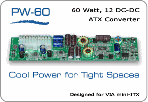

i ran into these sites already. Below is probably the power supply that will work for me but the fact that i can get a 400W power supply for $20.00 and this 60W 12V Power supply costs $50.00 is rediculous.
Im looking more for a way to modify a regular power supply to work for what i need. Much cheaper.... I just need a way to get my cars 12V source split down to 12v, 5v, 3.5v and -12v.

This article popped up in my mail today:
http://www.elecdesign.com/Articles/Index.cfm?ArticleID=7460
Its a design application note for a dual output DC-DC converter.
If you mess with the circuit a bit, and add a few outputs, you might find it to be a low nonsense solution for your application.

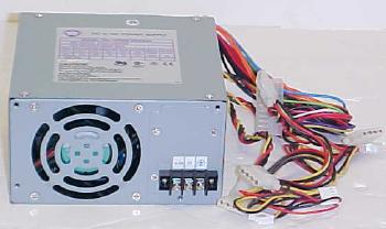

There are a few power supplies on ebay that would work perfectly for me except for one thing. It needs 24V DC input.
link:
http://cgi.ebay.com/ws/eBayISAPI.dl...&category=42019&sspagename=STRK:MEBWA:IT&rd=1
Anyway I can step up my car's 12V supply to 24V? Without adding another battery? (Cost of a second battery + this power supply isnt worth it when I can get a 12V power supply for my ITX board for about $50.00 shipped)

I agree that it likely isn’t worth the hassle of a second battery with parallel charge, series discharge complications.
If you can find a 12 to 24 VDC DC-DC converter you could use that to step up and run this thing.
You could also buy it and try fiddling with it to change the input voltage... but how close it is to this thing is hard to tell:
