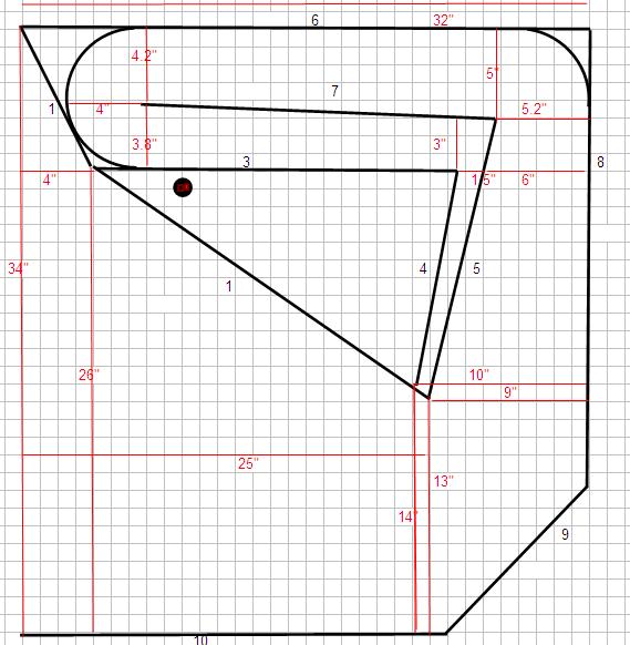

Id love a labhorn, but cannot afford to buy 2 drivers, i can hower afford(well save for) a single lab12.
how would i go about changig the design for use with one driver, is it as simple as cutting it in half and having a rather slimline labhorn, or must it be redesigned?

If you use one Labhorn driver, both the front/rear chamber volumes are halved and St is 0.707x the original. Fl/Fh/efficiency stays the same, but the compression ratio is doubled. Probably fine for most music, but won't go low enough with sufficient efficiency for movie special effects or large pipe organs unless coupled to a corner to continue the flare.

chopping in half,bad idea.

hey mike, so if i was to use your design there, te last one on the page, it would work well, whats the max SPL on it. not that it could possibly be lower than i want
Also i have 200w so i will have enough.
looking at those specs i could fit that in my room as either a coffe table or make a corner free and use it.
would i need any EQ to stomp those4db humps at 85hz and 130z?
and with those internal corners and bends would i need to use curves like in the other sketch.
Cheers Mike

The curves are only important for high freqs,which this woofer isnt meant to play.
200w is plenty, youl just about blow your brains out at 1metre, 125db
Since ive designed it ,i think if u want to build it, you can do so at your own risk, i plan on building it as SOON as i can afford the woofer!
none of those plans are finalised-just to give u an idea of the size and shape.
EDIT: those bumps are due to mouth reflections from it being too small...im filtering at 70hz so its no bother

http://www.geocities.com/loudspeakerguru/subindex_page4.html
about halfway down the page is a fully worked, single driver labhorn design...

This is a very clever folding scheme by Jeff, and looks good. Too many folds for response above 80 to 100Hz, but you won't get this from the Lab12 driver anyway. Certainly a design to consider.

I don't want to be picky but since your sections open up in only one dimension they are actually parabolical sections. Conical horns have a cross section that is growing by the square of the distance.
