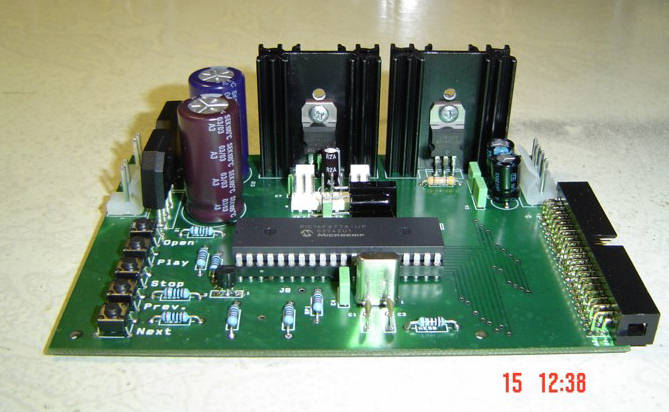

With this board you can control cdrom basic functions for using it as a drive...
Price for the assembled kit is 39 Euro.
See http://www.rockna-line.com/cdrom.htm for orders & questions..

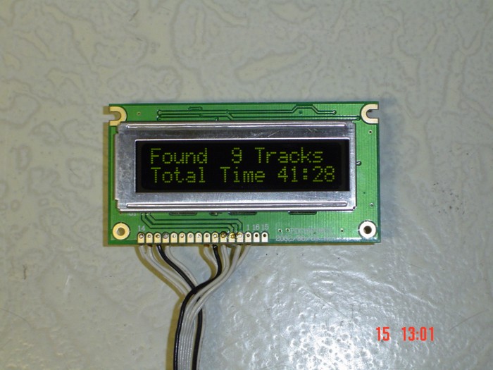

Also, I take it that any 2 X 16 dot matirx display with a HD44780 control chip will work with this, so that a vacume flurescent display could be used in place of an LCD type?
Andrew.
Andrew.

The circuit works with any Philips cd-player remote control or compatible, including the remote from cd-pro2. You can control the following functions:
- PLAY/STOP/PAUSE/SKIP/SEARCH/REPEAT/RANDOM
- 2 SEARCH MODES (NORMAL/FAST)
- 2 REPEAT MODES
- DIRECT TRACK ACCESS
- 4 MODES TIME DISPLAY
- STANDBY FUNCTION
The PSU for the cd-rom unit is included on the board, so you only need the AC source.
Tested on following units:
PLEXTOR PX-54 TA
TEAC CD-552E
TEAC CD-W540E (writer)
BTC BCD40SB
LG GCE-8520E (writer)
ASUS CDS520
The shipping anywhere in the world is max. 10 Euro.

Since I have at home some nice 4*16 LCD displays, is there way to show text on all 4 rows? If not, which rows will be used ?
Cheers
Andrea
Cheers
Andrea
It seems that text will appear on 1st and 3rd line.
Anyway it will be very easy to modify firmware, but I don't have any 4x16 display to test.
I tested a 4x20 display and works fine, without any mod. The data is shown on first two lines. So a 4x16 display will work 100%. 🙂
