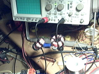

Turns out that adding the caps to the bridge only took care of the oscillation at idle. Once a signal is added, the output waveform gets the 'fuzzies' on the negative half of the wave.
The driver boards are connected with a female plastic connector that pushes onto male pins on the chassis. By adding .01µf caps to the ground wires running to the driver board, almost all the oscillation is gone.
However, I noticed that the most improvement came when adding the .01µf cap to the ground for the Zobel filter. I suspect that this filter, which consists of what looks like a cheap cap and a wirewound resistor, is the problem now. When the speaker switch is set to disconnect any load, there is no oscillation at all. With the dummy load connected, there is the small bit of oscillation on the negative peak of the waveform. Since the oscillation, small though it may be, disappears with the load disconnected, I'd like to replace the filter with some better parts and see what happens.
Below is a pic of how it is set up now. I thought it odd that the filter is on the far side of the inductor/resistor combination. Is that why the values are so large (33 ohm and 1µf..), or is there any reason why I can't use a more standard value of like 5-10 ohms and a 0.1µf cap?

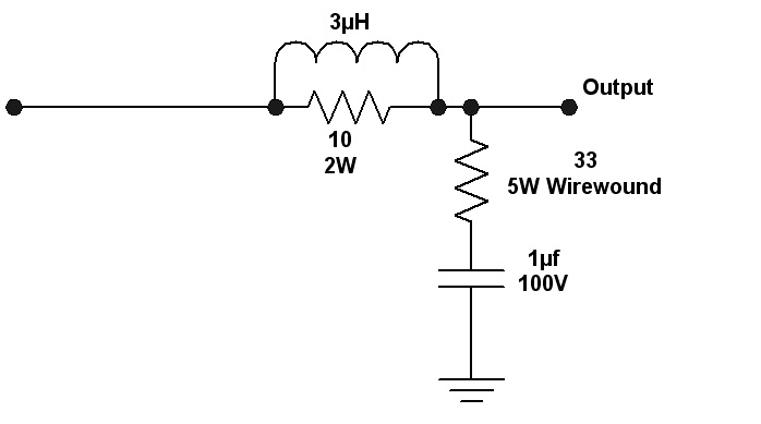

If you can, I'd put the zobel 'before' the L||R thingie, using a good quality 0.1uf cap & 10R3W. Also try to 'bypass' the power rails with .1uf as close to the output devices as possible and I'd add a tinyl value cap (68pf or so) across the amp's input (signal+ to signal ground.)
Thank you very much for the reply.
It won't be easy to move the filter, but it can be done. I certainly don't look forward to pulling those driver boards out yet again, but I got no choice.

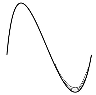

The 3MHz oscillation is gone. What I have now I call 'oscillation' for lack of a better word. It actually is more of 'mild instability' on the negative half of the wave, slightly blurring the waveform and becoming more pronounced as the wave approaches its negative peak. The positive half of the waveform looks just fine. Moreover, the phenomenon I describe does not present itself until...
1) A load is connected, and
2) Power output approaches 100W
With no load the wave is clean as can be. This is why I feel it may lie with the poorly chosen wirewound resistor for the Zobel filter. Any other thoughts on moving the filter before the R||L output coil? Or the size of the filter components?

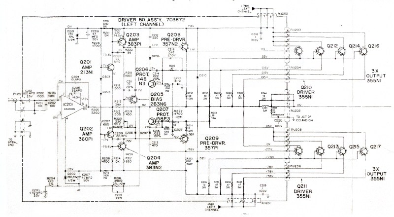

I'd scan the schematic, but sections of it are shaded, and may be tough to read. Still, I'll see what I can do.

it required an output bjt or two, a few drivers and resistors, and the pre-drivers to put it right.
What exactly did you change?
Wow...
Well, this thing was fairly smoked. Q210 (driver) was shorted, as well as Q212 IIRC. Anyway, since I had no idea what these '355NI' devices are (although they were labled Toshiba), I moved Q211 to where Q212 was, and replaced the drivers with 2SD555's.
The pre-drivers were also toast, and replaced with 2SA1535's and 2SC3944A's.
All of the .47 ohm emitter resistors were open, and were replaced, as well the 10 ohm 2W resistors for the drivers.
Bias transistor was shorted, and replaced with a 2SD756A.
D206 in the protection leg was shorted, and replaced with a 1N4148.

This 'fuzz' in the waveform is transient oscillation that only happens with certain Vce/Ic conditions that make the transistors not fast enough to have less than 180º total loop phase shift up to frequencies where there is no longer feedback
I've also seen this problem when replacing 'equivalent' transistors in quasi-complimentary output stages or even when replacing VAS transistors of the same model but from different brand and with different capacitances
The problem obviously comes from the transistors you have replaced
The drivers you've used are probably slower or have higher capacitances than the old transistors. Try to decrease the value of the 100ohm 0.5W resistors from the base of the drivers to the output and the negative supply respectively, this will 'speed up' the circuit again [try 47 ohm]. Take into account that reducing the value of these resistors will increase the idle current through the predrivers and now they may require heatsinking. Try also reducing the value of the 10ohm 2W resistors connected to the bases of the output devices
Increasing the value of the 22pF miller capacitors from B to C of the voltage amplifier transistors may also help eliminating the oscillation but this will actually reduce the gain-bandwith product of the amplifier and its slew rate

Also, your 'no comment' on the Zobel would seem to indicate you think that this is the wrong approach...

The RC network on the output is ok as long as it presents a low resistive impedance at high frequencies. The circuit needs this resistive load in order to have a fixed bandwith independent of what you connect on the output binding posts. A simple 4.7 ohm 1W or 2W resistor and a ceramic or film 100nF capacitor is more than enough to accomplish the task.
The reason to use a power resistor is to prevent it from overheating and opening in case of slight RF oscillation, since without the RC network the oscillation may get enough amplitude to cause cross-conduction on the output stage and blow output devices. In normal working conditions, a 0.25W resistor works fine [as long as you don't amplify full amplitude high frequency signals] since there is no RF to heat it and the 100nF capacitor shows 80 ohms at 20Khz

Eva, you are most kind to help out...your suggestions are appreciated. I do have 47 ohm resistors here, but they are only 1/4W...do they need to be larger?
Also, looking at the prints. C213, the 470pf cap on the B-C of Q209 seems large. That cap needs to charge to pull the signal down. What is the possibility that this cap is too large and causing problems?
lucpes suggested moving the Zobel so that it is located 'before' the R||L output filter. Is that worthwhile? If not, I will simply replace the 33 ohm resistor with a 5.1 ohm, and the 1µf cap with a .1µf cap.

There's always a downside...so what's the downside of adding the resistors to the B-E of the drivers?
(I will try this tonight....and since relocating the output R||L filter or the Zobel is difficult (but not impossible) I will simply replace the 33 ohm resistor with a 5.1 ohm, and the cap with a good quality .1µf and hope for improvement)
.....other projects have gotten in the way, and now 've got to go to St. Louis for two days.
Looks like I'll be waiting and installing the 47 ohm resistors and the reworked Zobel at the same time once I return.
Eva, thank you... I'll post once I get back and have a chance to put the parts in...
For that circuit, the downside is increased bias current through the predrivers and increased idle dissipation
There is also a small THD increase since Vbe is not linear with Ib nor Ic, but having the amplifier oscillating causes far more THD increase anyway
Before I take off, wanted to post a small (but bad..) drawing of what I see. In the drawing, the grunge on the negative wave is a little exaggerated, but wanted to give a general idea of what I see.
Perfect wave with no load, odd negative waveform with a load at high (90W+) output.
