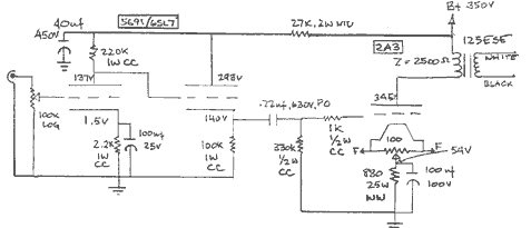

I am building the circuit below (Angela easy 2A3), and it sounds quite good, certainly better than SRPP or simply 1/2 a 6SL7. Sounds very neutral and not too euphonic. Nice to listen to however. Bass is tight and power is up.
However there seems to be a prejudice against cathode followers, people really don't like them. Anyone tell me why?
In the below circuit, I would also like to try a 6SN7 as the driver tube (i.e. half 6SN7 per channel), how would I do this? Is it as easy as changing the 100K cathode R to a 47K?
Sure, or even 22k. I'd remove the cathode bias from the 2A3, run the CF ground return to a negative (-100V or better) supply, move the coupling cap to before the CF and apply fixed bias to its grid. That way you can run a smidge of grid current, making for more graceful clipping when at full power, important with only 5W to spend.
As for people hating CF's, well, people are stupid. :devilr:
Tim
Aside from personal tastes and preferences, the argument is that cathode followers (or emitter followers or source followers for that matter) employ 100% negative feedback and of course as everyone knows, negative feedback is bad. 🙂
It's a bit ironic really. Those who don't care for the CF because of negative feedback tend to prefer triodes over pentodes, even though pentodes have less inherent negative feedback than triodes.
Go figure.
Is it?
The more advanced argument should be:
Some CFs are bad sounding, the one in the schem in post #1 being a typical example, not because of the local NFB but because it's just a lousy circuit.
See Tubecad for a more indepth explanation.
Overuse of global NFB loops is also a no-no in good audio design, local FB loops as used in well designed CFs and triodes is generally preferred.
Penthodes: well, isn't that a thermionic device with a local feedback inhibiting grid?
And what is used to linearise that entire circuit? You guessed it, overall NFB, the more the merrier.
That's just scratching the surface though, suffice it to say that believing that any amount of feedback is a cure all is a sad case of selfdelusion...
First of all try to understand how a circuit works, than see what FB can do and can't do to help it along if it can at all...
Cheers,😉
