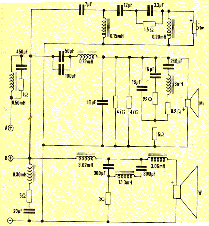

KEF C80 CROSSOVER SCH
BobA
this is KEF C80 schematic
W = KEF B139
Mr = KEF B160
Tw = KEF T33
