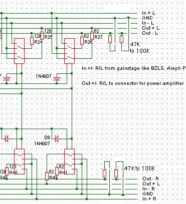

I have a question for you, I and looking at the Aleph 1.7 preamp
and found a 87LPC762 to replace the dead 87C752 from Philips
is it difficult to program these circuits both for volume control and selection of entries ?

Alain,
Waynes answer would be very interesting for me also. The main problem with the relays switching i do have is, when relay signal it make a lot of noise. The intersting task of the code is how to supress such noise.
I use a relais attenuator with MC for my BZLS.
Last rev. does the following:
- reading rotary encoder and set the 8 relais in range from 0 to 255
- store the last volume used and count up to it after power on
- on push function of the encoder change between 2 sources
- at source change change the volume setting to the one last used on that source.
- from one value up mute between switching the relais. (supresses some noise)
- at sourcechange mute for short time. (also supresses some noise.
- at power up wait some time with mute before count up the volume, choose the last source used.
- the code tries to minmimize errors from bouncing of encoder switches.
Its designed for minimal parts and elements at user interface (1 knob) no fancy features. MC uses internal clock so not much hardware needed.

François said:

Till,
>>The main problem with the relays switching i do have is, when relay >>signal it make a lot of noise. The intersting task of the code is how to >>supress such noise.
Yes the noise is a major pb when switching!
I don't need 255 positions I would be happy with 64 or 128 pos...
Nice to have...
Nice function ... get only one coder to do the job
> - at source change change the volume setting to the one last used on that >source.
Fine also...
> - from one value up mute between switching the relais. (supresses some >noise)
Well I need to have "no noise" while switching, its very important.
> - at power up wait some time with mute before count up the volume, >choose the last source used.
> Its designed for minimal parts and elements at user interface (1 knob) no >fancy features. MC uses internal clock so not much hardware needed.
I have seen your site, great job.
I need to figure out how to suppress all noise from such a design,
because I would prefer a carbon pot like ALPS without noise to a relay
solution that brings noise....
Question:
Do you have a board for programing the device?
How do you put the program on the chip?
Regards.
If you could tell me the position you like i can sort out the others for a firmware rev. Alain.
I prefer the fine resolution of 255 steps.

Total SWAG, but how about 47-100K from each signal line to ground to prevent it floating while relays are switching?

Thanks, it cannot be a cap, because it would distord the signal
so the resistor is the great idea.
Thanks for your precious help Bob.
I will install 2*6 relays {to make 2*64 steps} on a PCB with 1% precision attenuation resistors and try a 100K to ground on each signal line.
Will rapidly hear the results... {Hope so !}
PS: What a good memory you have !
And are there better relays for this application: Reed relays with screen or...

Alain,
I have no practical experience with it, but that's what I was thinking - let me know if it works.
Bob
Bob
