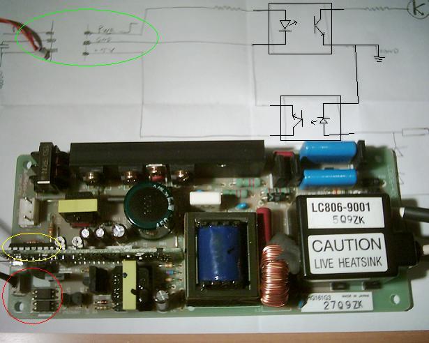

Here it is as promised, a pic of the half of my projector’s PSU that is no longer used.
Inside the red circle are the 2 OptoIsolators and 1 end of the cable that connects to the main board,
Inside the yellow one is the 494 PWM chip that is supposed to control the output.
Inside the green circle is the other end of the cable and the drawing of the 3 lines ; “PowerOn”, Ground and the so important +5V that has to be pulled low.
The 2 squares on the schematics represent the “insides” of standard OPTO’s.
Hope this helps.

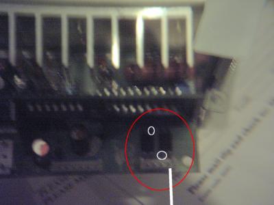

OK, here's a pic of the PCB (sorry for the crappy quality, my camera has no macro mode, so I had to use the old magnifying glass trick). I circled the 2 chips and cable connector which I belive are responsible. I drew in a white line where the white wire connects, as the other 3 are blue. I think that the white may be power or ground. I also circled in white where there's a white dot around the pin on the circuit board, maybe this will help. Now what's your advice from here? If you need a better pic, or one of more of the board, let me know.
Ok, that surely looks like it.
The fact that they are facing opposite ways (just like mine) PROBABLY means 1 is for the “PowerOn” signal and the other for the “I’m PoweredOn” return signal.
You gonna need to grab a meter and do a few things but

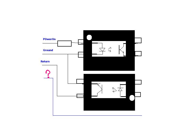

Draw 2 optos on a paper and try to complete the circuit around them.
Have a look at my drawing and try to compare.
1- Find out which wire is connected where exactly (the 4 of them).
2- Find out which wire is ground. This will be connected to both Optos on the same side as the connector. To do it, reconnect the wires to the main board and check for continuity between mainboard ground and the pins on the optos.
Don’t use the PSU ground since they should be different grounds. This is the main objective when using OptoISOLATORS.
Or if you have a meter that can test Diodes, with the Projet switched off, put the RED probe on the pin marked with the white dot and the BLACK probe on the other pin on the same side of the component. If it reads approx. 1V the Black is Ground.
If it reads 2.999, The RED is ground, (but I doubt this is the case)
3- Find out which one is pulled High (+5V) when you press “PowerOn” – this should be the one that connects via a small resistor (to the white dot Pin), since you can’t put 5V straight to the Opto.
You can check this on the main board side. It is easier and since you will have to power the projector to be 100% sure, it’s definitely safer to do it on the main board.
4- Find out which one is always High, (+5V) and maybe needs to be pulled low.
5 - And what is the extra wire and where does it connect to?
Once you have done this, and drawn a circuit, post it here and we can discuss the next step.
