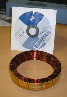

I finally bit the bullet and got some inductors made up for me.
They worked out at £12 each for a 2.4mH inductor wound using 1.5mm wire which is tightly bound, impregnated with varnish and then baked hard for 8 hours.
I bought 4 of them to build my first monoblock power-amplifier - they weigh 750g each. The quality is excellent, i'm very pleased and looking forward to using them.
If anybody has interest in these or similar inductors then you can contact Dave Stephenson direct on +44 (0) 1622 670338.

40+ years in audio and I've never seen an inductor like that. Do you mind telling me what they do in the amp?
What do they do?
They are to be the L element in a Pi filter.
I'm sure they could be more compact, but the size is not an issue to me as i have pretty much as much space within the monoblock enclosure as i need.
I intend to use a CLCLC arrangement with these inductors and 58,000uf capacitors - probably overkill, but this is DIY so no problem.
Got the inductor dimension details from here...
http://www.colomar.com/Shavano/inductor_info.html
...and then had the coils wound to the spec suggested from the website.
Measured on an LCR meter at 2.4mh and DCR 0f 0.45ohms so pretty close to calculated values.

not built my power supply yet....
Sorry can't give details of how things have worked out on these inductors as i've not put the supply together yet (still awaiting capacitor delivery from the group buy, but that will happen anytime now).
The leads are hidden beneath the inductor - they are about 300mm long and will allow me to stack the inductors in such a way as to create mutual inductance (i'll be using a CLCLC filter) and increase the realised inductance values.

Jason, Can you post a close up picture?
Of that coil inductor. I'm thinking of winding my own and was wondering just how perfectly commercial coils are wound.
How coils are wound
Bear in mind i'm drawing on my own very limited experience here, but it seems to make some sense....
The first thing you need is a former - the width of it should be a multiple of the diameter of the wire that you are using.
Feed the width and the height into an inductor calculator website (the link i gave is definately not working properly, but the one that is mentioned later in the thread is better anyway as it allows more control over the parameters used to calculate the answers).
Using the answers generated from the website as your guide wind the coils as tightly as you can onto your former. You could use cable ties to hold the coils in place when you remove the windings from the former but i'd not keep them there any longer than necessary - replace them with cotton tape spiral bound around the coils and tied off tightly, then remove the cable ties.
My coils were then immersed in varnish for 10 minutes and baked for 8 hours - there is absolutely no chance i can see of the coils resonating against each other or breaking free for the others
