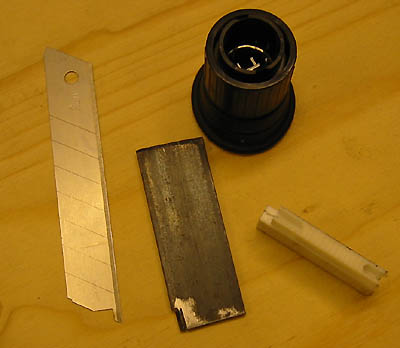

(Apart from the soft plastic material that the arm knife edge bearings sit in. They do disintegrate, and I don't know how to repair them).
My bearings was also more or less destroyed, but I made new ones ,not easy. But it can be done
First I milled a bit of plastic so I had on dimension (wide?) to the right mesuare. then milled a "precut" for the groove. then I took a piece of metal wich was filed to the final shape of the groove, heated it up and melted the groove into final shape. then sawed and filed the the remaining sides. Maybe it could be done without a mill but it will be harder.
