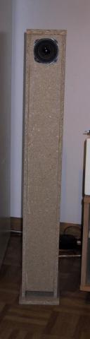

Here a picture of the final prototype before finishing.

Way to go! I wanted to do the simmilar project with exact drivers.I Ended up modeling a ml tqwt with a monacor fullrange but I'm still wondering how would sound a straight pipe with this visatons.I acaully have 2 of them in D'Appolito serving as midrange in my 3 way floorstanders (I bought them from another DIYer).Looking forward to see the plans.Do they have enough treble?

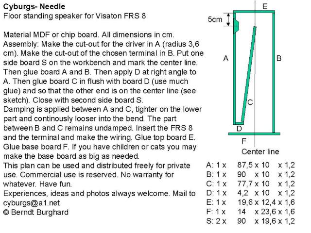

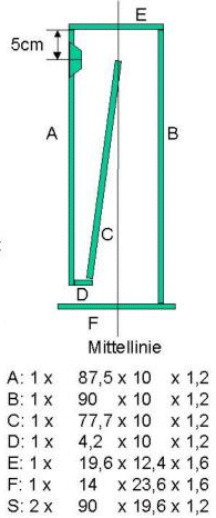

Here is the plan for this baby. It is really simple, and I managed to build one pair at one single rainy evening ;-)
Have fun, Berndt
@ Tomac: The trick with the treble of the FRS 8 is that you have to face the box directly to the listening position, because the FRS 8 (like all fullrange drivers) has quite a narrow sweet spot. However, the sweet spot is broader than that of other larger fullrangers I know, so that this is not really a problem. The height of the Cyburgs-Needle is about 90 cm, so that the horizontal alignment fits nicely to a typical sofa listening position. In my personal opinion the treble of the FRS 8 is quite neutral, not screaming, but also not dull. Its a really nice driver in my opinion. What Monacor driver did you use?

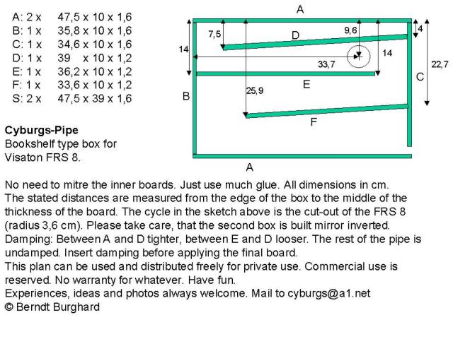

Cyburgs-Pipe
The second construction I'd like to introduce is a bookshelf type loudspeaker for the FRS 8. It is also a TQWP construction, but folded in four sections to get a rectangular frontside. It is a near relative to the Cyburgs-Needle, in fact it is the older brother 🙂 I posted this plan some time ago in a german forum and as far as I know, there are already three pairs built by some forum members. The prototype has been built by a friend of mine after my initial plan, and I always enjoy listening to them when I visit her. They are suitable for wall mounting and also for placing it on a bookshelf. But as for all fullrange speakers, it is necessary to point them to the listening position as far as possible.
So have fun also with this plan, Berndt
Attached to the file is a (again lousy) picture, but I will post better ones, when I have them. The cut boards are already in my workshop, hehe.

Your plans don't display.Check it again.Maybe the problem is same as it was with the picture.I like the look of your towers.I didn't know one could get 50Hz bass from this drivers because their Fs is 130Hz.Although I don't see the plans I guess this is a straight ML TL.Again,congratulations!

Hi Fingust,
the radius of the holes (I suppose that you mean the holes where the driver is screwed in) is 3,6 cm. The position of the holes you find in the plans.
The horizontal position of the hole in the needle is in the middle of the baffle.
I hope that this helps, nice greetings, Berndt
