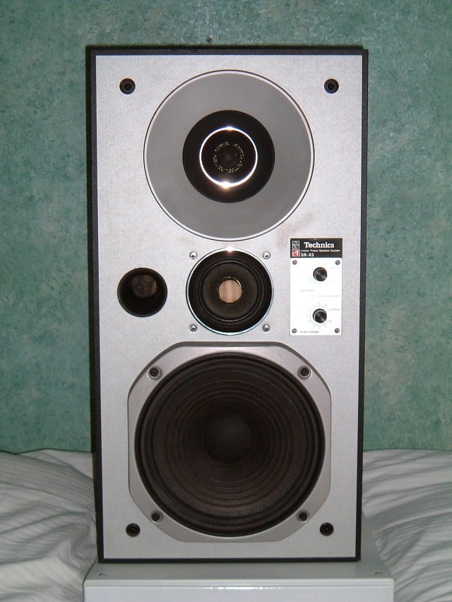

I hope i'm posting this in the right thread.
Here are my technics sb-x3 speakers.
I think they are from 1978.. and I don't like them! 🙂
Efficiency is 91dB and I drive them from an aleph60.
The mid-toner is modified with an unfinished wooden phase plug, wich improved the sound actually. (more open)
Remco Blankesteijn.

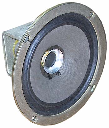

More Zenith Fosters
I found some more Zenith speakers with Foster drivers recently. First a pair of Allegros with 8" woofers (2000's ? No label) and the same Foster horns that were in the 3000's I mentioned in an earlier post. I was surprised to find that one had an alnico woofer and the other a square magnet. The horns were slightly different too. One had the tape seal and the other didn't. These sound pretty good - I think I actually like them better than the 10" ones. The bass is a bit more defined. Then I found some little Zenith speakers at a flea market last weekend. Plastic wood grain cabinet with a silver metal grill. No logo on the front but I noticed a white cone which I know is sometimes Foster. Turns out I was right. The "woofer" is a 4" labelled Zenith 49-1316, 8 ohm, 5 watt and Foster 8113. Ever heard of this one?? The tweeter is about 2 1/4" labelled 49-1317-01, 16 ohm, A ONK, Korea, 1192. Haven't had much time to listen to these yet. One of them has a loose connection to the tweeter. Good deals though - $5 for each pair . . . Charlie
