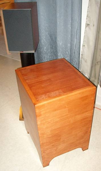

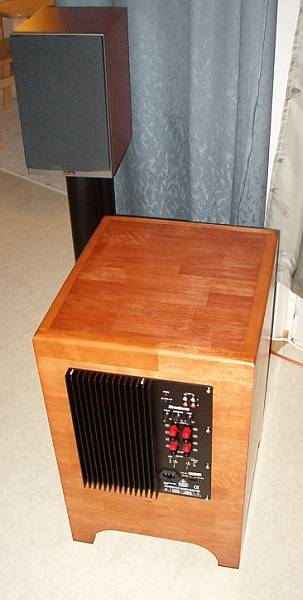

I have a DirectServo project in progress currently - enclosure has been glued together and I'm continuing tomorrow.
I'm building my subwoofer into a bit over 50 liters (internal volume)sealed enclosure. I don't mind the reduced sound pressure since my goal was to get really tight high quality bass with nice extension. A hifi-subwoofer to extend the frequency response of my Dynaudio bookself speakers.
...and that happens with the expense on SPL. If I would have used vented configuration I would have get at least 6 db's more. It is also going to be used in my home theater but two channel listening takes 95% of my equipment usage time.
I just wanted to continue to my previous post that it's ready. Looks came out as planned and so does the sound. Tight, accurate and nice extension. Goal was to make a high quality musical sub and I think project was a succes.
I attached a couple of pictures of the finished sub. It's made from birch and waxed several times. The speaker beside the sub is Dynaudio Audience 52. This picture is from the front...

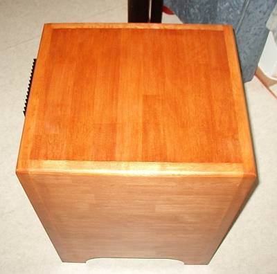

That's strange - I can see the pictures. Since I'm a 'newbie' poster on this forum my messages are not shown instantly. When I left my post I didn't see my it or the pictures. But now both are shown - for me anyway...?😕
Let's make a test - I'm attaching one more picture that shows nicely the difference in the color between top and the sides.

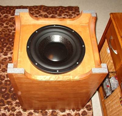

The woofer looks A LOT like Titanic. I noticed that also when I received it. I'd could bet that it is manufactured by the same company as Titanic (Eminence?) but with a bit different specifications. It feels - and sounds also - like a quality woofer.
I guess the best - kind of - word for the sound is 'invisible'. I haven't noticed any technical faults (hiss etc.) or 'musical' shortcomings. It works as good amp should - not to be noticed but present the music as it is. It also has power and impact more than enough for myself.
I have not XO'd my main speakers at all: I have adjusted - by purpose - my system so that the sub continues where main speakers naturally roll off. The sub XO is adjusted to the minimum which is 40hz.
Downfiring?
Hey Mobster,
Nice sub you have there. I am looking at doing the same thing and was wondering about the downfiring configuration. My quick scan of the Rhythmik site didn't turn up any recommendations on that, but checking the calculation given on the parts-express formula page I think that woofer may suffer from sag.
Unless I am calculating it wrong. The specs given on the Rhythmik Audio site indicate 1.2" peak-to-peak excursion and fs=26hz. I interpret that to mean Xmax=15mm, giving about 15% sag.
Any comments from more knowlegable sources?
Thanks,
/Dave
Let's see... If I use the formula on the PartsExpress page:
Percentage of Sag = 981,000 / (Xmax * (2 * Pi * Fs)²)
The woofer has 1.2" peak-to-peak excursion which means it has 0,6" of Xmax. That translates into 15,24 mm of Xmax. FS is 26hz.
Let's use the formula:
"(2 * Pi * Fs)²" = (2 * 3,14 * 26)² = 26660
15,24 mm * 26660 = 406298,4
981000 / 406298,4 = 2,41
So the answer is 2,4% sag.
Not so much I think?
