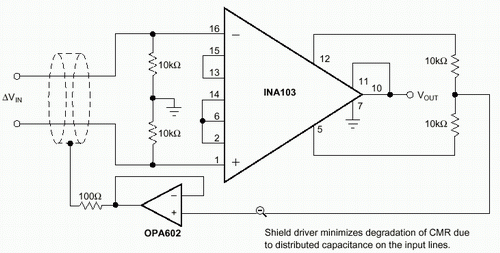

Much more sense makes to me to bias the screening.
You can either bias it with a fixed DC (this is how I understood HH's approach with the batteries in his reference passive preamp - I heard it once in some setup) or with a shield driver.
Quote from the BB specsheet of the INA103 for an instrumentation amplifier:
A shield driver minimizes degradation of CMR (Common mode range) due to distributed capacitance on the input lines.
Klaus
