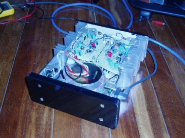

The voltage rails are plus and minus 25V, we are talking about 25W on 8Ohm and 45W on 4Ohm.
I have to check if the author allows me to attach it. It's a simple design just for beginners. Differential input (I'm going to fit a balanced input soon), Vbe multiplier, some other things and Mosfet push pull output biased with approx 250ma.
I'm very proud mostly because all the parts are recycled, and total cost was the transformers, the paint and the polish

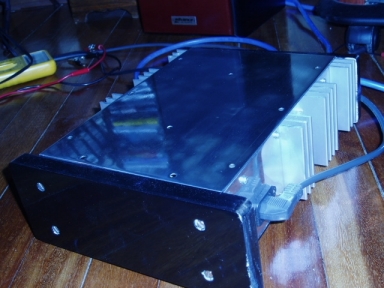

I like very much using my head instead of my money. I had a lot of broken devices, and that's like food for the hyena 😉
I used "L" pieces cut from an aluminium box to link all the parts, another Al piece from the top and bottom, nuts and bolts all from the scrap, heatsinks too, and the switch fuse and AC connector from broken PC power supplies.
I'm also building a preamp, based on a buffer and a inverter stage with a pot in the feedback loop, both with OPA2134. This design is from the same guy, and the target was to avoid the pitfalls of a standard pot. The downside could be that altering Õthe feedback I also change the "character" of the sound, but don't know if this is of capital importance. It's almost done but the box and the second channel of the phono stage, so you will have more pictures very soon.

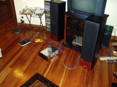

In the second picture, the first violin concerto of Sostacovich (Analog_sa! where are you?) was playing

Nice amplifier in a cosy place!
