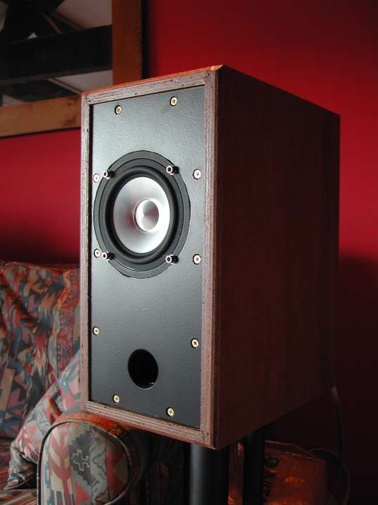

I thought I'd share some pics of my latest project, a pair of Jordan JX92S-based monitors.
Vital statistics as follows:
Dimensions: 40h x 21w x 31d approx (cms)
Internal volume: 15l
Mass: 10kg each
Cost: £200/pair approx
Freq response & more details to follow...

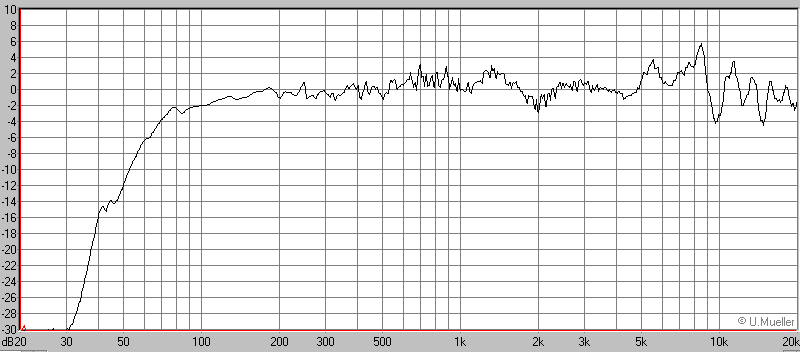

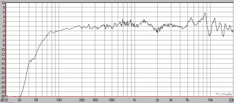

IanHarvey said:
Here's the frequency response of the unit shown, measured on-axis 10cm from the centre of the driver cone, using a Behringer ECM8000 mic.

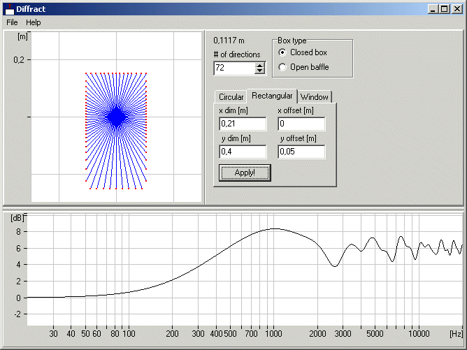

Hmm... Are you aware of baffle step? Unless I miss something you will have to add about this to your close-field measurement to get the far-field response. 😱
Yes, I did some simulations when positioning the driver. It has both an x and y offset from the centre point; that plus rounding-off the baffle edge made it less wiggly overall than the plot you posted.
I'm undecided whether to (a) leave the speakers alone and fiddle with the room & positioning, (b) add a passive compensation network to the speaker or (c) put compensation between source and power amp. I'm also not sure how I'm going to measure the result, as my experiences to date suggest in-room response is so messy a little 6dB step is lost in the noise.

Ahh, nice, I just guesstimated a y offset from your picture, but as you say, it is likely that an x offset would dewhiggle the response a bit more. BTW, What *are* the measures?
I don't have them to hand at the minute; the X offset is about 1.5cm if memory serves. I'll post some construction details when I'm back at home.
I think most people nowadays use a truncated impulse response to measure far-ish field. How did you go about to get your curves?
I'm using AudioTester (http://www.audiotester.de/), using its frequency-sweep mode. It does have a waterfall-plot mode (which I've not really played with) - is this what you mean?
I didn't want to simply simulate the baffle diffraction results and then design its inverse as compensation; in the room where they will eventually live the baffles will be effectively flush with various bits of furniture. I'd like to actually measure the speaker+room together before fiddling with the frequency response.

mulebarn said:
The speakers look nice----real good job! 🙂
Thanks!
I'm still in the middle of listening tests and some final tweaking, but it sounds at least as good as it looks. To give an example, I put on a bit of Bach - one of my regular test tracks, which I must have heard a hundred times on a couple of dozen systems - and was amazed to suddenly hear someone turning over the pages of music! Definitely some detail I hadn't heard before; the stereo image is wonderfully precise - a notch up from my Monitor Audio Gold 10's, even.
At present, the bass is a little light. It's clean and detailed, great for jazz/acoustic stuff, but it doesn't really rock yet. I might fiddle with the ports some more (although I'm not a fan of bass-reflex 'boom'), or the baffle-step correction described earlier would of course boost the bass and low-mids.
