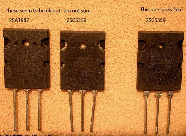

I got some 2sc 5359 (5200's elder bro) and the complement 2sa1987, both have Toshiba markings and are black.
However there are 2 kinds of 2sc5359 with slightly different fonts... I broke it up and checked the die sized were a little different.... probably fake, but is there a chance that a later batch may have slightly smaller die's?
Also the dies are slightly smaller than the 2sa1302....
Something smells right? 😡

The C5359 is the sub for C5200. I am attaching pics of what I think genuine and what I think is fake. For all I know both may be fake. :xeye:
The one on the right has different fonts than the ones on the left. The labelling is not very legible on both.

Could you measure zero-bias C-B and C-E capacitances of all these devices?
A simple capacitor tester should be more than enough to perform these measurements as long as it uses voltages low enough and no DC
For genuine devices you should get 5-10nF capacitance values, for counterfiet devices capacitances may be as low as 1-3nF [due to much smaller die sizes]
If somebody has some transistors known to be genuine , it would be a great idea to measure its capacitances and post the values here to help other people to know if their devices are genuine

I used a Elenco CM-1555 cap checker. (uses a 9v battery/psu) I do not beieve it passes any DC but sends an AC frequency to the device under test and measures the attenuation...anyway
I got different readings based on the polarity of the leads I used.
For the good pair (ones on left in the picture)
with Black probe on C, I got:
CE=403 pF
CB=12.63 nF
With red probe on C, I got:
CE=401pF
CB=441pF
For the bad part (which I think is fake, rt one in picture)
with black probe on C I got:
CE=390pF
CB=797pF
With red probe on C I got:
CE=407pF
CB=503pF
Looks like the good ones have larger die, but I cannot still say if even they are genuine.

Obtaining different capacitance values depending on the polarity means that your capacitor tester is applying some DC
Try to filter out the DC using something 10uF in series with the capacitor tester a 1Megohm in paralell to the junction of the transistor
The other problem may be your capacitor tester using a too high test voltage [>500mVpp]. This is harder to circumvent but placing 1nF or 2.2nF in series with the juction to attenuate te measuring signal may work, but then you have to calculate the effective capacitance of the juction based on the measurement [for series capacitors : 1/C_measured = 1/C1 + 1/C2]
My capacitor tester [Monacor LCR-4000] works fine for transistors and diodes because it uses no DC [internally AC coupled] and the test signal is a 600mV p-p sine wave [not enough to turn on the juction diodes]
EDIT : You made a little mistake when measuring, the capacitances you have to measure are C-B and E-B, not C-E

I got the CB/CE from your previous post.... 😀
Anyway, I measured my cap checker, lo and behold is spews out 1004mV AC and about 1.2v dc.
I am not sure I can perform the readings you want because placing a 10uF in series will make the reading high enough i.e. I will have to step toa lower sensitivity setting that will make me lose the decimals to measure the smaller values
... based on what I had previously... can any inference be made?
-K
Oops, the mistake was mine when typing, sorry
Placing a 10uF capacitor in series won't affect the measurement since it will appear as a short circuit in series with the junction, but it will filter all the DC
For example, I have here some genuine Sanken transistors that measure :
2SC3264 : C-B = 1nF, E-B = 10nF
2SA1295 : C-B = 1.7n, E-B = 8.4nF
I also got some fake 2SC3264 that measured C-B = 0.5nF and E-B = 2.7nF
I opened a fake device and a genuine device and found that capacitance figures were a very good indicator of die size
You can take it as a reference since these devices are rated at 230V, 17A, 200W, 2A@100V S.O.A. and Ft>40Mhz
Your devices may be all fake since the 12nF C-B figure is clearly due to junction diode turn-on [measuring in the other direction may work] and is not real, and the rest of measurements are almost equal
Knowing E-B capacitances would help to decide
