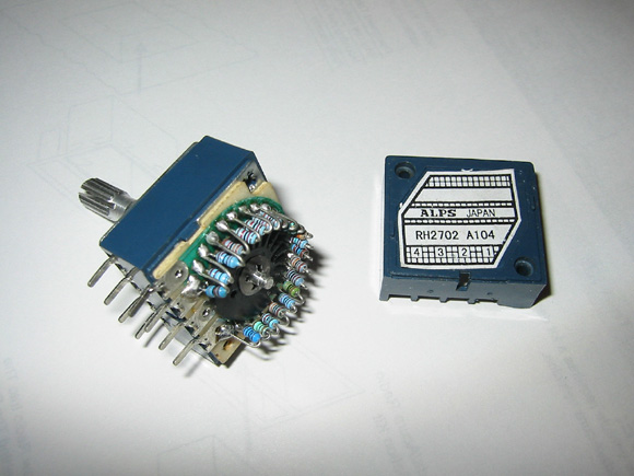

If anyone is interested in a dis-asembled eBay alps:
First pix:
Another:

Ciscokid - and how does it work and sound?? Does it pop between switching?? Or are/were you satisfied with it??
Yes, as mentioned in my previous posts. I have a pair of mono blocks and use one pot in each. One of the first set developed a pop within a few days of use. I ordered a second set thinking that perhaps one of the first was bad. After replacement through, still had the popping between clicks between about 9:00 and 11:00 on the dial. The other monoblock has started popping too, however not as bad just annoying.
Hope this helps..

Btw - Ciscokid - is it hard to dismantle it?? Are ther any "tricks" I should know if I will have to do it??

well, maybe not so good.
Hmm, I wonder if widening that copper contact patch would help give it a better connection to the contacts on the wafer.
Oh well, guess I better play it safe, and stick with the crappy pots I have, at least they don't pop and click.
