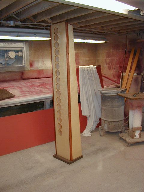

This is just a follow up to the line array questions I posed last week. Thought that you might care to see the cabinets... They are birch MDF with a birch corner stile. The cornert stile provides the strength for the glued splines. Base is 1-1/2" MDF with granite look laminate. Overall height is 81-1/2".
I'll drop in the drivers this week and start wiring. I am open for any sugestions on the type of caulk for sealing the speakers to the baffle. Suggestions?

Looks good, but where are you going to put the tweeters? I thought you said that you were using the Pioneer 269-568 extended range 4" drivers along with tweeters.

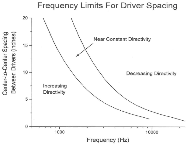

You will get interference patterns if you run those drivers above if you run them higher than around 3khz. Read over Jim Griffin's Linus white paper for more info:
http://www.prism.gatech.edu/~gte929u/LinusWP.pdf
This also means that comb lines will occur at around 6khz.
image taken from the above document.

Hey! You stole my idea! I've got 40 of these drivers waiting to go in to cabinets. You will definately need tweeters with those drivers. I built a mini line with five of them, an the HF response was terrible. I added one of the Dayton PT2's, and the whole thing just opened right up. If Ravens or BG's are out of your price range, give the PT2's a look. They're not the best out there, but neither are the wide range Pioneers.

Here are the answers to your questions... Please take an opprotunity to review my questions at the end of this reply.
1. Yes, there will be tweeters. The holes aren't drilled yet because the tweeters have not arived from parts express. They come today??? There will be an array of ~ 24 to cover seated & standing height. Anyway, I can punch those holes after I decide what bits of plastic can be removed from those tweeters.
2. Yes, I understand about the interefence, but I don't understand how it will sound. With the 269-702 tweeters, the crossover has to be above 4000. So your suggestions are welcome.
3. Yes, it went together fast. About T + 10 days right now. Thankfully, I have a buddy (from the Scout troop, but he's thirty now) who works in a cabinet shop. In addtion to routers that already have tools mounted, and drills that are always mounted, and DA's with medium & fine, there's all the other "perfect" equipment. These should sound good, but they better look like they weren't made on a dirt floor. I'm still married for 28 years and I have some real bad habits. Got it?

chipco3434 said:Yes, there will be tweeters. The holes aren't drilled yet because the tweeters have not arived from parts express. They come today??? There will be an array of ~ 24 to cover seated & standing height.....I am thinking of wiring the driver series groups with 14, then weaving in 12 down to the posts. Two sets of posts per speaker... woofer side & tweeter side. I can bind them later if necessary.
i counted 16 holes for the 4" this post says 24. bit confused. are there 8 more on the back?
assuming 24 drivers per side.....
16 in the front and 8 in the back....
4 drivers in series in 1 set = 32 ohms
4 groups in the front, 2 in the rear.
32/4 ohms in front = 8 ohms
32/2 ohms in rear - 16 ohms
use 6db at 3-4k for front 16 drivers (8 ohms)
use 6db at 200-300Hz for rear 8 drivers (16 ohms) this will compensate for baffle step.
hope this helps.
