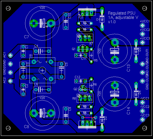

Shall I proceed to PCB this circuit, then?
I did a PCB layout. Does it look okay? It appears that you're all in agreement that the circuit does not have fundamental flaws, it just doesn't work the way the book explained. On the whole, soft start is a good thing anyway, so no harm done anywhere, I guess.
Will you give me feedback on the PCB layout? Single-sided, with just one jumper (shown in red). Not exactly as compact as some of you guys can make it, I guess, but shows nice symmetry. 🙂
Should I provide for some load resistors for a steady background load of, say, 100mA on each rail? 100mA x 20V will be 2W. So I guess a pair of 1W carbon resistors connecting each rail to ground should do it.
Double that power rating. A little margin is a good thing.

C11 and 12 have bigger dimensions (can be electrolytic).
Steady current is too high (why wasting ca 6Watts)?
What about heatsinks on regulators?
