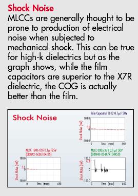

I was under the impression, though, that C0G was not microphonic. I also have some Taiyo Yuden ceramics that are supposed to be "low distortion/low shock noise." If anyone ever decides to do any serious investigation I'd be happy to send some over.

"All ceramic caps exhibit some form of piezoelectric effect. G dielectrics (as in COG), also known as NPO, have the lowest piezo effect and the lowest TCC (temperature coefficient of capacitance) of the popularly available ceramics, usually not noticed unless you are looking for it.
X7R, Y5U, and the other dielectrics exhibit much larger piezo effects and TCC. Barium titanate is often used in these dielectrics. That compound is also the main ingredient in most devices deliberately using the piezo effect (grill lighters and sonar transducers). Normally piezo is not a problem unless large forces are involved on the chip and the circuit is high impedance as the piezo voltage is a fairly high impedance signal. Your cap manuf should be able to give some guidance if you have a problem.
