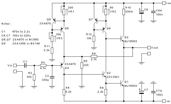

For those who are interested, there is a later, more
sophisticated (read: complex) version of the JLH whose
output is direct coupled. You can Google it right up, or maybe
some kind soul will post it, as I don't have it here at home
with me (read: too lazy to do it). 😎

here it is

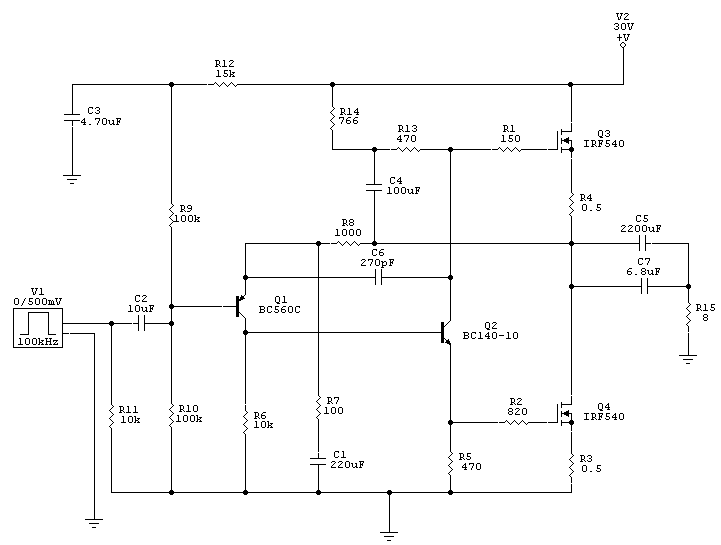

but some who have tried both say that this sounds better
( now why is it that the first one shows a picture and the second one shows a link ? perhaps someone can explain )

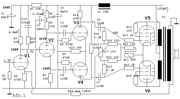

For the sake of completness, some are of the opinion that the idea for JLH simple class A had it's origin here.
I guess everything comes from somewhere. I guess it's just a question of degree
