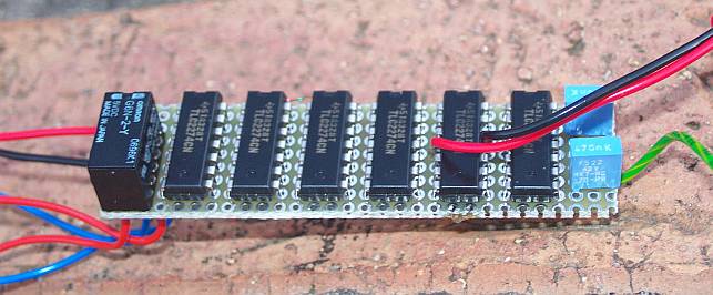

There seems to be a certain religious fervour attached to the opinion of whether or not opamps sound ok for audio. I have vaccilated back and forth about whether I should use one or not, and currently in my setup the only one is inside the DVD player right after the D/A converter; some 8 pin thing made by JRC.
Anyway, what I decided to do was make an opamp buffer cct and have a changeover relay so I could listen through it or bypass it completely, and have a long wire so I could switch it from my normal listening position. I chose a Texas Instruments TLC2274 quad fet opamp simply because I had a few. Also, the distortion as a buffer is only 0.0008%. Naturally as with all stuff diy, things got out of control and before I knew it I had no less than 12 opamps wired in series as unity gain buffers in each channel. I wired it between the DVD player and the power amp.
Well, what did it sound like??? I was expecting the worst, BTW.
Hiss - Only the tiniest, tiniest, weeniest increase in hiss.
Distortion - no obvious change.
Frequency response - no obvious change.
Overall clarity - no obvious change.
Left to right soundstage - again, no obvious change.
Front to back soundstage - aha! Instead of extending off into the distance somewhat, it only sounded as if it was about a foot deep. Not objectionable, just different.
It took me about 10 minutes of listening to actually pick this difference - it was simply not a black and white thing like some people have claimed. Also, if someone else was operating the switch I have some doubts that I would have picked the difference.

That is an interesting experiment. I haven't done something like that, but am aware that mixing and other consoles used in producing some of those fine sounding LPs and CDs must contain also many, sometimes 100's of opamps. Of course, it's not the same, but makes one wonder why a single opamp on replay would have much more influence than say 10 or 20 on the recording side.

Great experiment !
Not many people realize that their beloved recorded music went through a long chain of op-amps already, in the mixing console for instance.
But it is not the op-amp by itself that makes sense but the right op-amp in the right place. The so much discussed I/V converter here on the board is one of the trickiest applications for an op-amp.

That i have learned many moons ago but with my favorite null test...and more... i haven't yet measured a op amp that make a deepest null, than the "old trusty" NE 5534...
Do it!!...see post in post #8 in :Circlotron said:Null test. Of course!! I'll definitely try that. Thanks Tube_Dude.

the sound of concatenated (low-quality cheap) opamps is in every (modern at least) recording we listen every single day.
The sound of concatenated high-quality expensive opamps does not exist unless you do the recording yourself,
I have said this many times: if you take a look inside a studio mixer, you wouldn't care if you had used a 324 in your preamp.

I had mixed feelings about Circlotron 's test...and I do not think it gives more than a single opinion on a single test.
The same op-amps in another config. would probably sound/measure different.
Try them with different gain, in a filter, with capasitive or inductive load, among muting transistors and other "artifacts", and they for certain will sound different.

I wonder if the soundstaging thing you note may be a function of the added noise?
The added noise and the added distortion of each op amp...because in audio "Less is more".
A op amp can have low distortion...but in a string of of amps ,that in normal conditions, are not needed the distortions will add.
If Ciclotron do de some experience ,with a string of no feedback amps...the output wil be very diferent from the input...

I have used TLO74's for over a decade as unity gain buffers. I cannot hear the difference between those and NE5532's in this application IE a well laid out PCB with quiet linear PSU, balanced audio inputs and outputs, and metal case.
Now, whether there would be a difference in a CD player, where some gain was used to use it as a Sallen-Key or Butterworth filter, and loads of digital and RF mush around, is too complex to analyse.
