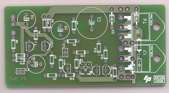

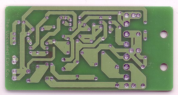

Mr Pass!
Submitting details:
For a start, here is the boards for the citation diy. I kept them very small to keep wires around the mosfets as short as possible.
The output devices ar mounted from underneat with the pins bent 90 degrees forward, this allows for a 4mm thick alluminium plate with corresponding holes for the transistors as distance wich makes a very tight assembly on the heatsink and the boards need not be secured any other way.
Submitting details:

Hey Ingvar,
Would you be able to post the gerber for that pcb? Very nice job! I might want to build up a few of those......
Thanks,
Mark
Thanks,
Mark
Hi Mark
I´ll send You the gerber files, just have to browse through the computers to find latest version.

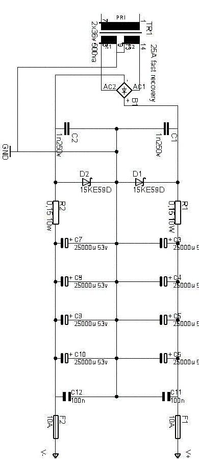

The power and output connections on the board are designed for the exelent powerpole 30amp system but standard terminals for amp crimp cable termination works alright.
I designed power supply boards, also mono, with space for 2X100 000uF and surge arresters, i dont use them, dont like the idea of running this much current through 35u copperfoil.
If You want them i´ll mail these to
pls let me know progress

Thanks to Brian i now have the schematic for the complementary version. Layout will be done tonight, the result will be posted here.
Design will be doubblesided as i want plated throug holes, solder result is far better that way. For those who want to make own boards, You only need the solderside, no jumpers needed, i use componentside only to increase area of power and output wires.
