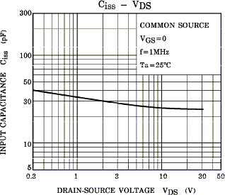

No, swap the feedback and input gates of the jfets to get a noninverting stage for to jfet pairs. I believe most all of the voltage gain is in the bipolar second stage to reduce the Miller capacitance at the amplifier inputs. You will need jfets with Idss of at least 8 mA to get this circuit to work with 100 ohm drain resistors for the fets. Since most of the Toshiba jfets ideal for this circuit that are easy to find are the GR bias group (Idss from 2.6 to 6.5 mA), you may want to increase the drain resistor value and cascode the jfet. I would use 20V rails if cascoding the input stage and bias jfets at least 10 Volts drain to source to get the devices capacitance down.

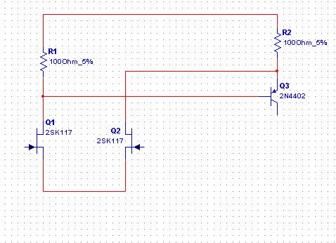

I found another way.
you can swap the drains of the Jfets and leave the rest unchanged. for example, the left E212 should have its drain connected to the positive rail via a 100ohm resistor. and the right E212 should have its drail connected to the emitter of the 2n4402. the schematic looks like the attached chart. I got the ideal from the "is 150w enough" discussion of yesterday.
It essentially swap'd the two inputs and turning the original inverting amp (in the JC3) into a non-inverting design. I remember John talking about why he wanted an inverting design back then.
edit: the emitter resistor in my previous chart had the wrong value.
edit 2: hm, the new chart didn't get uploaded. Anyway, R2 should be 20ohm to be consistent with the original design.

Can't a guy get a night's sleep without everyone wondering how this schematic could be possible? ;-) Well, the schematic is wrong. It was caught by me after this schematic was first published, in 1977, and was corrected by me in a LTE of 'The Audio Amateur' in the next issue or so.
Yes the polarity is inverted in the schematic.
You must reverse the connections to the emitter and base on both sides.

Swap the gate leads or alternately the drain leads for both jfet pairs.
I don't what all this nonsense about swapping base and emitter is about. THIS IS A VERY SIMPLE CIRCUIT. There are only four transistors in it for crying out loud. It is not that difficult to understand. I don't understand what all the confusion is about.
From: http://marklev.com/JC2/index.html
"John Curl's correction to the Line module was that as it is in the drawing you got the signal from the E212 to the 2N4403 should have been taken from the OTHER E212. The same applies for the E175 and the 2N4401."

Fred, maybe this is too simple for you but XG's solution of swapping B and E fixes the problem in a very elegent and simple way.

Don't want to upset you, but you either don't get it or you are to stubborn. The idea is to swap the B and E connections TO THE INPUT PAIR. It seems that everyone including JC agrees that that fixes it, except you. I know, if the majority selects a wrong it is still wrong, but in this case I think you are out in left field.
Jan Didden
Fred, think it through. Even with the leads switched, the second stage is still essentially a common emitter drive. I just added the alternate input lead to the emitter of the second stage because it seemed to be an OK thing to do. It does have some subtle advantages.
What you are thinking is that it becomes a common base second stage, and sometimes I do design circuits that way, but in this case the common emitter overwhelms the common base connection. However, if you put a large bypass cap at the base of each output transistor to ground, it would become common base driven and the circuit could practically only operate open loop. Both Chas Hansen and I design some of our latest circuits with a common base drive for the second stage. It is then called a folded cascode connection.
