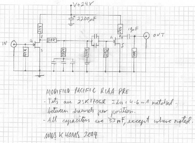

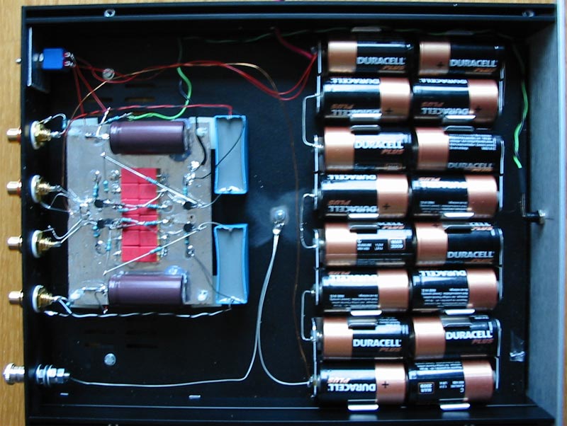

This morning I threw together my own version of the "Pacific Riaa Pre". I can now say that I have a completely Single Ended feedback-free amplifier chain (Pacific+BZLS+SOZ) 😀 And a really nice sounding chain it has become.. This crude little riaa pre is too good to be true. My intention is to tweak it like nothing has been tweaked before (cascoding etc), hence the "fast & furious" building style; it's very effective though (took me about 3 hours to make). All components are matched to the tightest tolerances and to get as close as possible to the ideal riaa values which are 22K4, 3K257 + 97n6, 100R + 33n5.
Well, enough rambling; do yourself a favour and try this circuit! 😉

Nope....too slow, i already see your handwriting on the "back o' napkin" schematic 😉

Hehe... If you can't read it, you can't build it 😉 I could have drawn it in EWB5, but I like to draw on paper. I've got a "diy journal" where I scribble all my efforts. I'm an engineer; I can't think without a pen in my hand and a piece of paper in front of me.

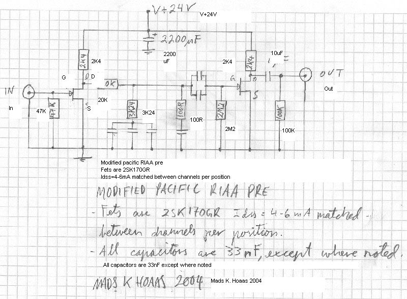

Would you mind to translate what youve written about the mosfets. Its a bit unclear to me, but lets blame it on the scanner 🙂

Well, scanning in 150dpi and compressing it to 100KB doesn't help much 😉
Here you go "Fets are 2SK170GR. Idss=4-6mA matched between channels per position."
That looks horrible, but correct. You forgot the G-D-S on the second JFet 😉 Maybe I'll have to make a real schematic for you
Considering its made in MS-Paint....its ugly but readable. The second fet is left out intetionally, since theyre identical.

2SK147 and 2SK117GR are drop-ins. Don't really know about any IR or ON parts. Many JFETs can be used, but I believe the Toshiba parts are particulary good sounding units.
One other thing; you need to check the recommended load capacitance for you pickup and plan accordingly. I don't need any extra load C because my ClearAudio Virtouso Wood likes about 100pF and my cable is about 50pF and the Ciss of the 2SK170 is about 30pF pluss you can add a little to those numbers.
edit2: and don't even consider not to use batteries with this circuit... SLA's are recommended I think (and do get 3 of them so you can have more fun with cascoding etc later 😉 )

This setup is for MM, but you can use medium output MC provided you make the load R suitable for your pickup. If you need more gain, you could just insert one more JFet stage before the first one for about 90dB gain (it's about 54dB as drawn). Or use a stepup trafo.
edit: if you insert a third stage, the amp inverts the absolute phase.
